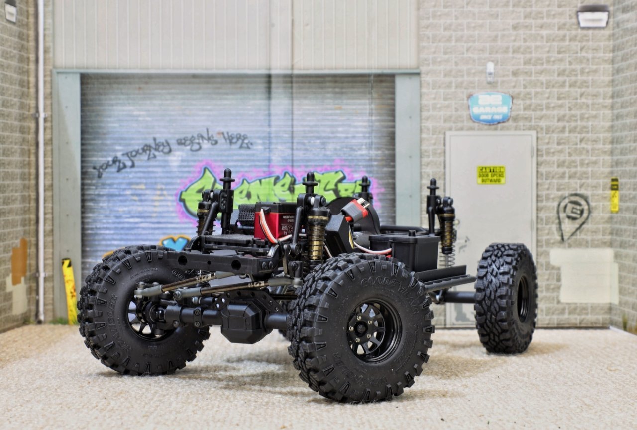

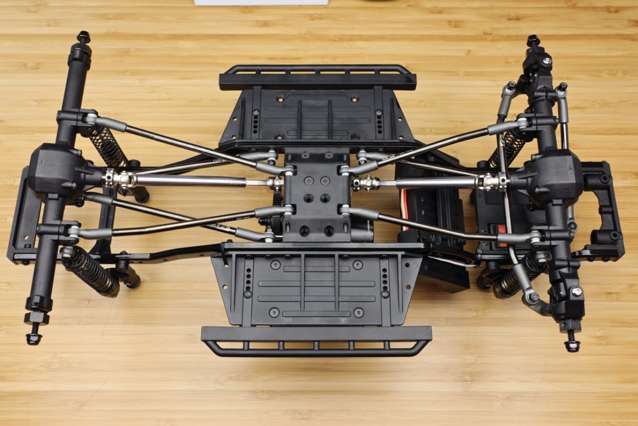

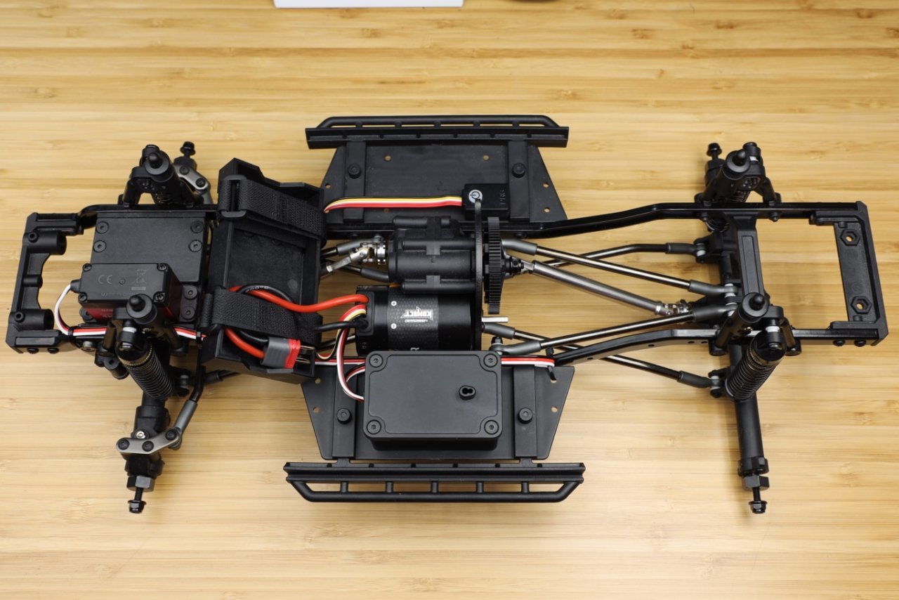

So here is progress report no.1.
Β
Bags 1 to 4 covering chassis and gearbox.
It was a nice smooth start although a couple of observations, either the manual references some wrong screws or the bag contained the wrong screws and the manual is correct.
Β
Nothing that couldn't be sorted though.
Β
Also managed to faux pa's at the first hurdle by not attaching the panhard mount to the chassis. I will chalk that down to my last 3 builds being 4 link instead.
Easy to fix just a faff when you have to undo a complete set of screws on one side of the chassis πŸ˜–πŸ₯΄

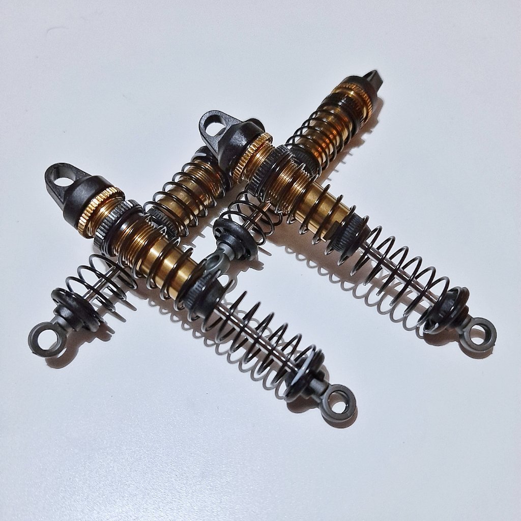

Next stop will be axles although I might skip to the shocks first as I always seem to enjoy shock building πŸ˜…
4 minutes ago, Stormbringer said:
Interesting battery tray position as wellΒ
Same as my Sendero HD and the other element models I’ve seen - works really well and the trail balance is beautiful
13 minutes ago, lorrylemming said:
Is the Konect system different to the hobbywing fusion? I always assume these things are just rebrands but it looks quite different.Β
The konect is made by hobbywing but apparently is shorter in length and lighter in weight.
11 minutes ago, tomr said:
That looks great even without a body πŸ‘
Cheers buddy, I'm looking forward to dropping the body on (once I get my hands on it) and see if my vision for the desired stance comes true.
