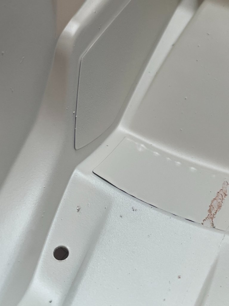

BigGinge Posted August 5, 2021 Author Share Posted August 5, 2021 I got the paint done on the shell today so starting to look a lot better now. since taking the last picture I’ve put on the stickers for the headlights but I think I’m going to leave all the others off for now. Since “finishing” I have noticed one slight issue in that I seem to have put the two mounting posts on the optional carbon fibre top deck on the wrong way round. So until I swap these round (with the taller one at the back of the car) I can’t get the clip in at the rear of the shell. I also had a bit of an issue with the supplied window masks when I was painting the shell so that has turned out quite as well as I’d have liked. The issue I had is that the supplied stickers started to lift when I was putting paint down so I’ve got a bit of bleeding around the edges of the windows. Not the end of the world but slightly annoying as it’s not something I’ve seen on any of the areas where I have custom cut masks from my tesa masking tape. 2 Quote Link to comment Share on other sites More sharing options...

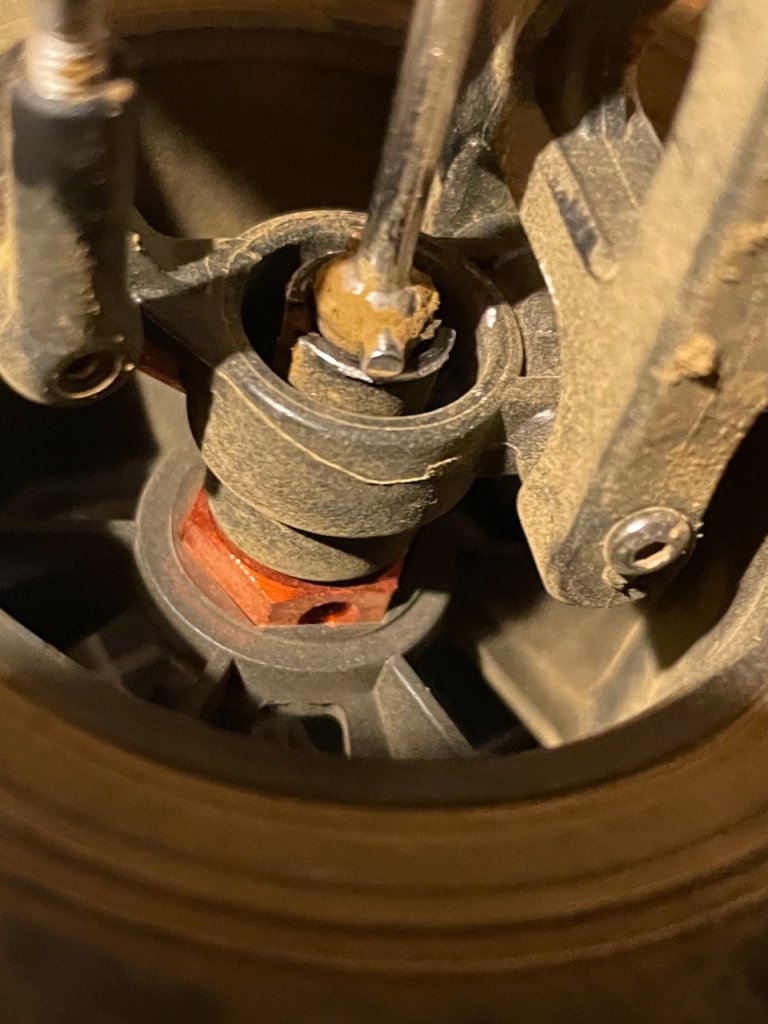

BigGinge Posted August 12, 2021 Author Share Posted August 12, 2021 (edited) I finally got to take the EMB-T out for its first run today. Went up to a local spot near us with a very loose dusty surface and I was initially a bit disappointed in how the car was running. It didn’t seem to be all that good in terms of its acceleration and it just didn’t seem to be gripping like I thought it would (I’ve run some of the same monster truck wheels on my XLF F16 up there before with much better results) so the handling wasn’t what I thought it should be either. After a little bit more driving I noticed that there didn’t seem to be much in the way of roost (not sure if it’s called that in the RC world or if there is another name for it) coming from the rear wheels, even though the front pair were happily chucking dust everywhere. I figured I may have lost drive to the rear wheels and that this might be causing the lacklustre performance. However, all the wheels were turning as expected when I was picking up the car so I assumed that the rear drive was ok. Anyway I kept running the car until we went back to fit a fresh battery to my sons car as it was still fun to play with, even if it wasn’t living up to my expectations. When I was fitting the new battery to my sons car I had a closer look at the rear drive shafts on mine and noticed that one of the dog bones had come out of the drive cup so was just spinning freely without driving the wheel when there was even a little resistance out on it. I’d noticed these seemed a bit short during the build but didn’t do anything about it. In hindsight this may have been a mistake, as it meant I had indeed lost drive to the rear wheels and I’ve now got one very mashed up drive cup and a lightly scarred dog bone from the first trip out. As a temporary (permanent?) fix for this I’ve taken the two spare universal drive shafts that I ordered when I bought the kit (these are fitted as standard in the front) and swapped these in in place of the dog bone and drive cup arrangement. Having a read of some posts on the EMB/LC Racing Facebook groups it looks like I’m not the 1st person to come across this issue so I may drop DMS and email to see if there is anything they can do/recommend to fix the issue with the parts supplied with the kit. Otherwise I may have to get some more universal drive shafts on order to top up the spares box. Hopfuly with the fix in place things should be much improved for its next trip out. Edited August 12, 2021 by BigGinge 1 Quote Link to comment Share on other sites More sharing options...

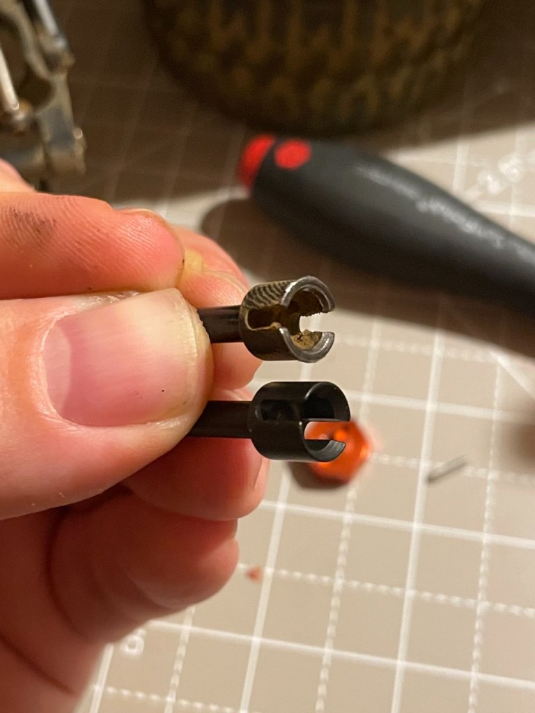

BigGinge Posted August 27, 2021 Author Share Posted August 27, 2021 So I’ve had this back out for a couple more short runs since swapping out the rear dog bones for my spare set of universal drive shafts (so I have these fitted front and back now) and it’s been behaving much more like I’d been hoping. The acceleration/speed has picked up a lot and the handling is head and shoulders above the other 14th scale stuff in the house. I have a feeling my lad would very much like to adopt this one as his own after having tried it out now (limited to 50% throttle as he’s only 5). So, I could easily see us getting another one if he keeps his interest in RC up and the stock situation improves at some point. I’ve still not run it up with a 3S pack in but it is plenty fast enough for me to bash about with off road on 2S with the 3100 kv motor and 19T pinion. I suspect I may get a higher kv motor on order (something closer to the stock 4500 kv),after trying this out on 3S, just to see what it’s like as it will only be £15 or so. 2 Quote Link to comment Share on other sites More sharing options...
Alex97 Posted August 28, 2021 Share Posted August 28, 2021 I'm sure there was a guy in the states who was selling more durable drive cups. I can't remember his name however he was on a lot of the LC Facebook pages. If you want a cheap replacement then the WLtoyz parts might fit. 2 Quote Link to comment Share on other sites More sharing options...
BigGinge Posted August 28, 2021 Author Share Posted August 28, 2021 I’m not sure there was anything really wrong with the drive cups, I figured it’s just what happens if you run most of a big pack through the car when the dog bone pins aren’t engaged properly. I’ve no reason to think they would have picked up any damage if the dog bones had been a bit longer. 1 Quote Link to comment Share on other sites More sharing options...
turok007 Posted September 2, 2021 Share Posted September 2, 2021 On 28/08/2021 at 14:20, BigGinge said: I’m not sure there was anything really wrong with the drive cups, I figured it’s just what happens if you run most of a big pack through the car when the dog bone pins aren’t engaged properly. I’ve no reason to think they would have picked up any damage if the dog bones had been a bit longer. could rubber washers be used to keep the shaft in the middle or even moving the shims around Quote Link to comment Share on other sites More sharing options...
BigGinge Posted September 2, 2021 Author Share Posted September 2, 2021 (edited) I have picked up some o-rings to drop into the drive cups to see if that helps centre the dog bones enough for them not to pop out. At the minute the universal drive shafts seem to be working without issue so I’m not in any hurry to switch back. Edit: these are the ones I ordered and they seem to be a good fit in the cups. https://www.amazon.co.uk/dp/B082SVQLQT Edited September 2, 2021 by BigGinge 1 Quote Link to comment Share on other sites More sharing options...
