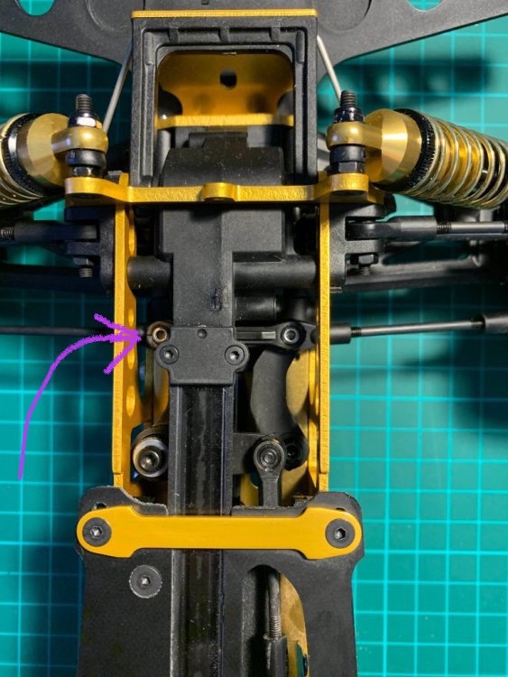

grumpyjunior Posted July 6, 2021 Share Posted July 6, 2021 Apologies for the newbie question. After not owning an RC since the mid 80’s I’ve just built my Turbo Optima RE RE and everything is fine except for one thing. The slightest bump and the left hand side of the Servo Saver link bar (see pic and manual) keeps popping off. I’m not sure if that is a ’thing’ with the Turbo Optimas or I have done something wrong. I am hoping to run it at my local track but am concerned that I am going to be constantly popping it back on lap after lap. Any help is greatly appreciated. 30619_TURBO_OPTIMA_IM.pdf Quote Link to comment Share on other sites More sharing options...
turok007 Posted July 6, 2021 Share Posted July 6, 2021 3 minutes ago, grumpyjunior said: Apologies for the newbie question. After not owning an RC since the mid 80’s I’ve just built my Turbo Optima RE RE and everything is fine except for one thing. The slightest bump and the left hand side of the Servo Saver link bar (see pic and manual) keeps popping off. I’m not sure if that is a ’thing’ with the Turbo Optimas or I have done something wrong. I am hoping to run it at my local track but am concerned that I am going to be constantly popping it back on lap after lap. Any help is greatly appreciated. 30619_TURBO_OPTIMA_IM.pdf 493.66 kB · 0 downloads looks like its snapped. Quote Link to comment Share on other sites More sharing options...
walkbythesea Posted July 6, 2021 Share Posted July 6, 2021 Here? Looks broken to me, I’d expect that to be a complete loop not have a split in it 1 Quote Link to comment Share on other sites More sharing options...
Bajadre Posted July 6, 2021 Share Posted July 6, 2021 yeah looks like rack is cracked etc should only pop upwards OP if its pulling a part sideways like Turok said Quote Link to comment Share on other sites More sharing options...
grumpyjunior Posted July 6, 2021 Author Share Posted July 6, 2021 Great spot! I think I need new glasses!! Would any of you know if you can get stronger ones,. It's seems a bit fragile. Quote Link to comment Share on other sites More sharing options...
walkbythesea Posted July 6, 2021 Share Posted July 6, 2021 Here’s the standard one, but it’s currently out of stock https://www.modelsport.co.uk/product/kyosho-servo-saver-optima--400919 What is the dimension centre to centre of the link? I’m just wondering if one from something else would fit? For example aluminium Ackerman links are available for the FTX Carnage/Outlaw models for about £3 from China Quote Link to comment Share on other sites More sharing options...

grumpyjunior Posted July 6, 2021 Author Share Posted July 6, 2021 Its 30mm from centre to centre. That is the Saver Shaft Plate (OT232). Quote Link to comment Share on other sites More sharing options...
walkbythesea Posted July 6, 2021 Share Posted July 6, 2021 1 hour ago, grumpyjunior said: Its 30mm from centre to centre. That is the Saver Shaft Plate (OT232). The FTX one is much larger, but you might find something from someone else Quote Link to comment Share on other sites More sharing options...
grumpyjunior Posted July 7, 2021 Author Share Posted July 7, 2021 Thanks for all the help. Trying to source alternatives and have found this. It's for the Optima and not sure it will fit the Turbo. I'm presuming they have the same Servo Saver? https://www.rcjaz.co.uk/kyosho-optima-2016-aluminum-steering-servo-saver-set-p-90075283.html?options={33}158&ref=cart 1 Quote Link to comment Share on other sites More sharing options...
walkbythesea Posted July 7, 2021 Share Posted July 7, 2021 23 minutes ago, grumpyjunior said: Thanks for all the help. Trying to source alternatives and have found this. It's for the Optima and not sure it will fit the Turbo. I'm presuming they have the same Servo Saver? https://www.rcjaz.co.uk/kyosho-optima-2016-aluminum-steering-servo-saver-set-p-90075283.html?options={33}158&ref=cart Nice! It looks the same, it probably is the same - at that price it’s well worth a try! 👍 Quote Link to comment Share on other sites More sharing options...
