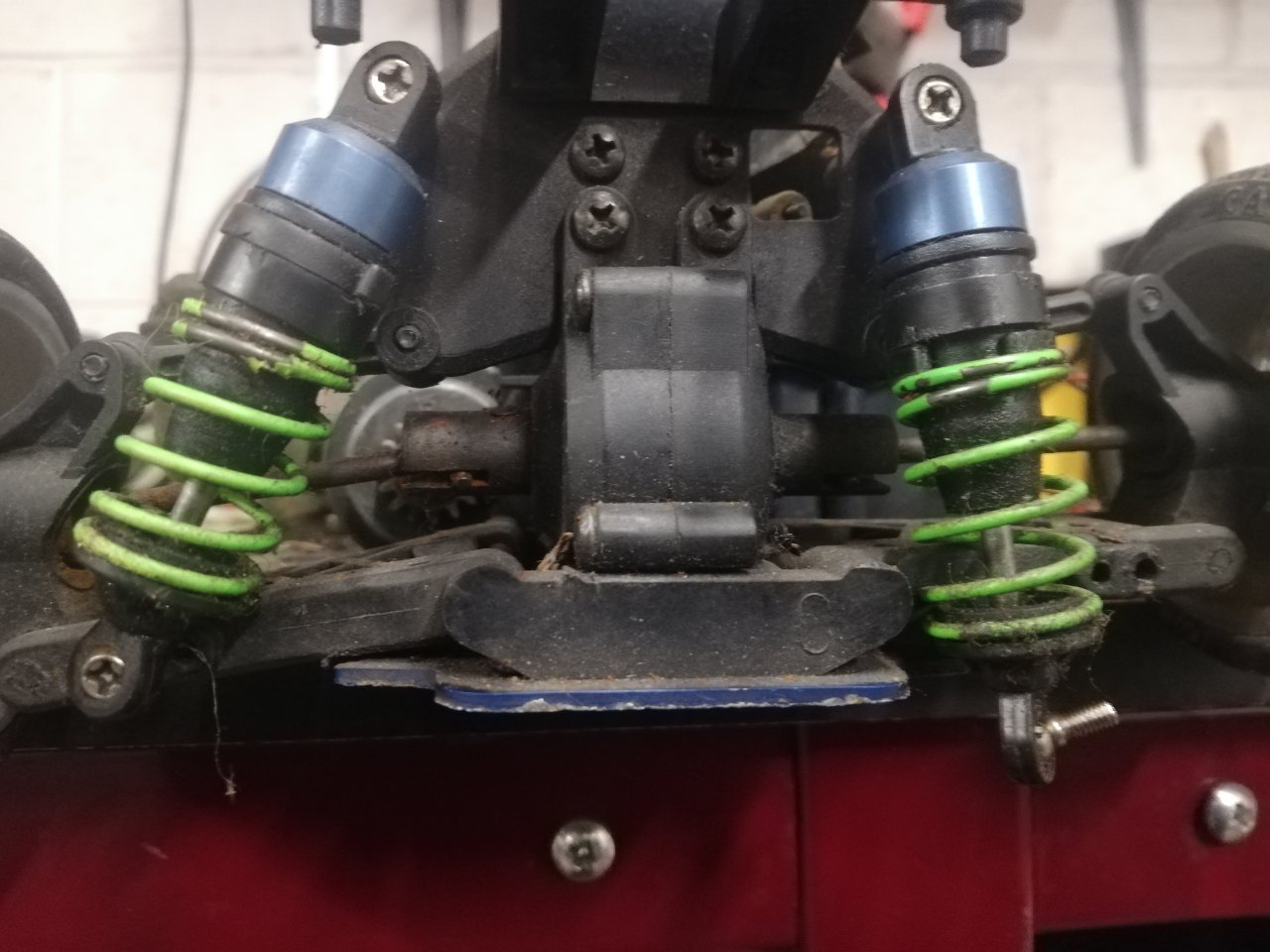

Also straightened a bent exhaust and fixed the order of the spring spacers as 2 were wrong. Rest of the car doesn't look badly built although engine was full of water!

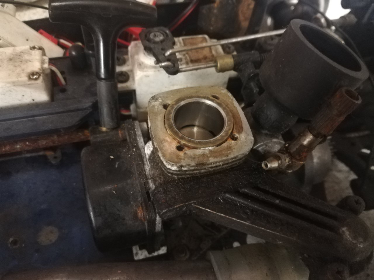

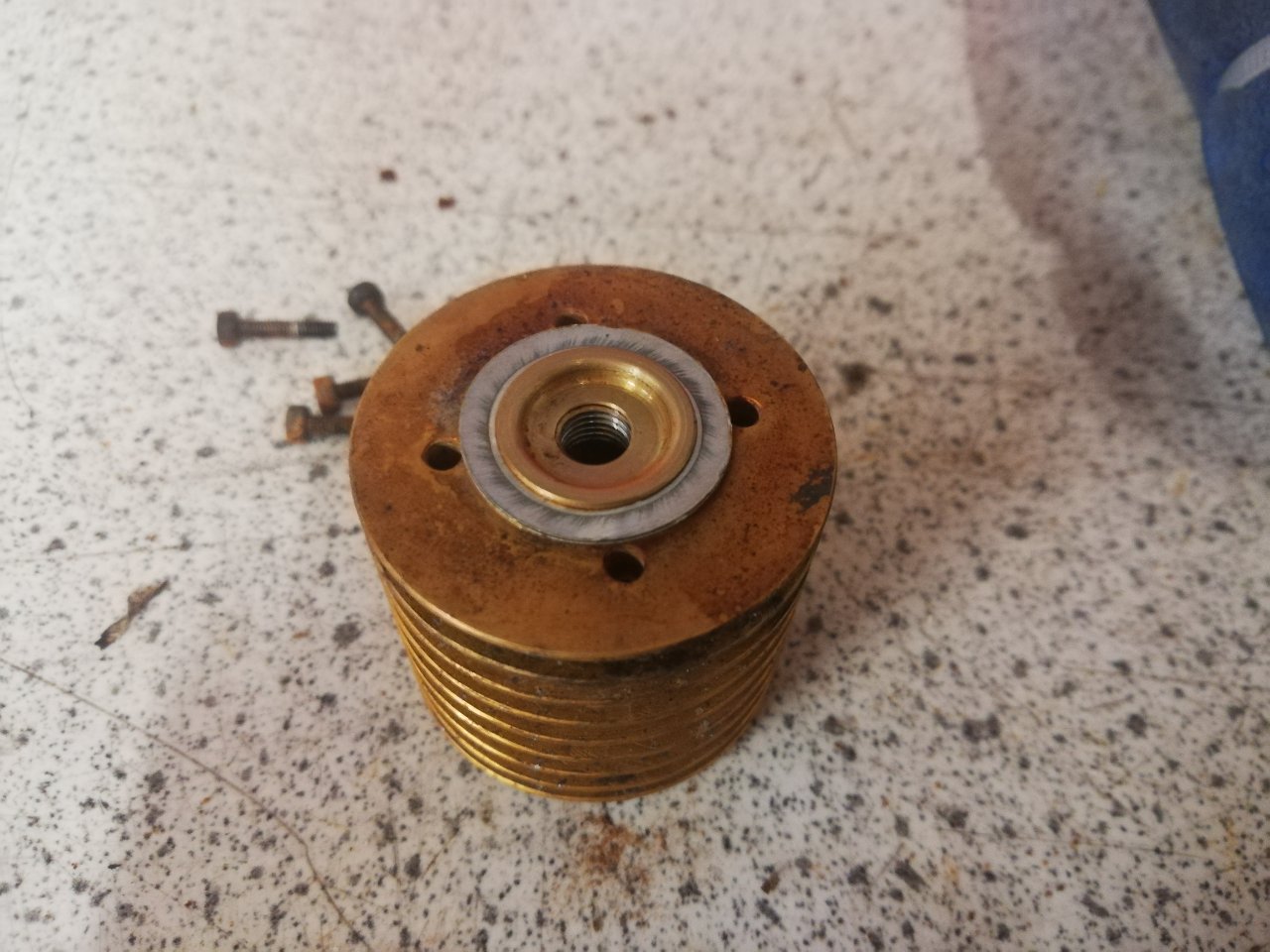

Thanks for the advice. Can I reuse the seal if I just pull the heatsink off for inspection?
Having no nitro gear currently I'm trying to be pragmatic. If it's never going to run I won't bother buying fuel, starter, etc  and trying.
Yeah if you can get the gasket off the back without damage you can reuse it, the head may have copper shims but no gasket to case issues and if the gasket tares you can get gasket paper from car parts shops or eBay, cut it out with a knife and you'll be all good
Thanks. I'll remove it and assess based on your advice. If it's just gasket paper to replace then happy days I'm pretty sure I've got some in stock.

Head/heatsink off tonight. Looks perfect in there to me. No signs of water damage. Seemed to be 2 alloy shims and no gasket?
Thanks chaps. Given the engine is good I've ordered fuel, hose, tank, starter and plug. Fingers crossed!

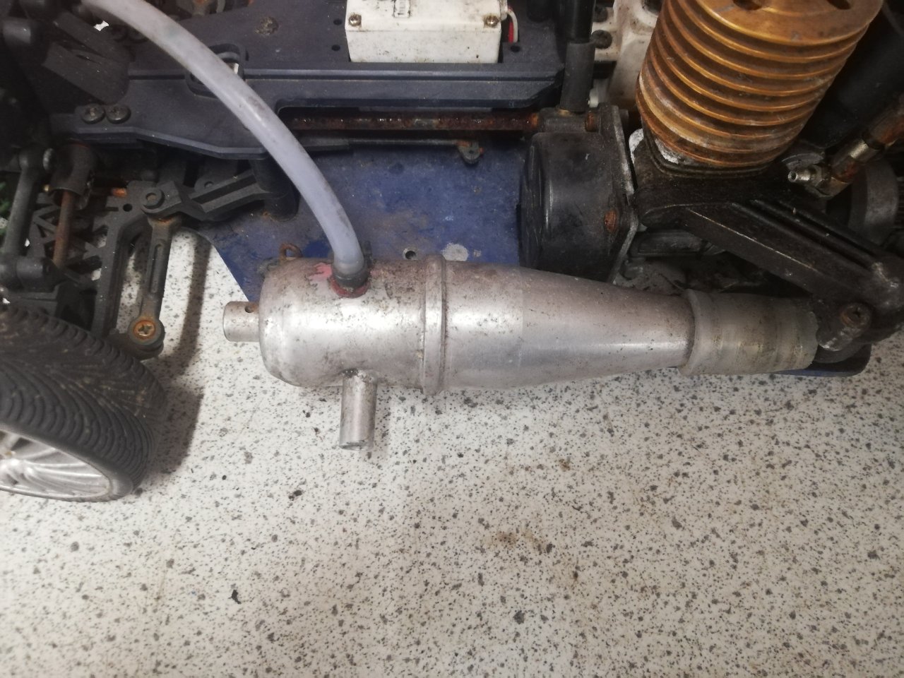

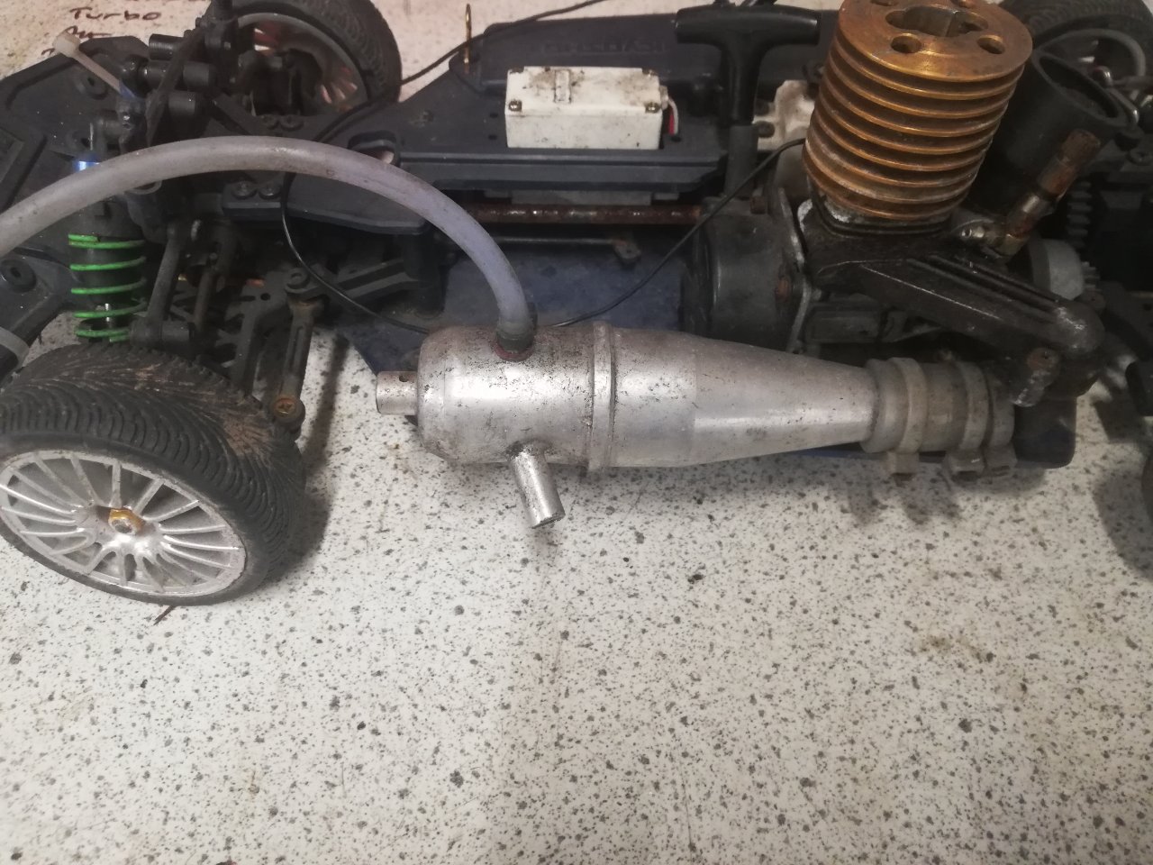

Tanks a little awkward. The filler 'safe drain off' makes it marginally too big but I'll get it in on a custom bracket above the exhaust bracket.
I would look at whether you c ould flip that tank 180'
Yes..your fuel line would be longer, but thats no problem if you prime it properly. Would allow the overspill drain to sit in an empty space, and the line from the exhaust to the cap would still run fine.
