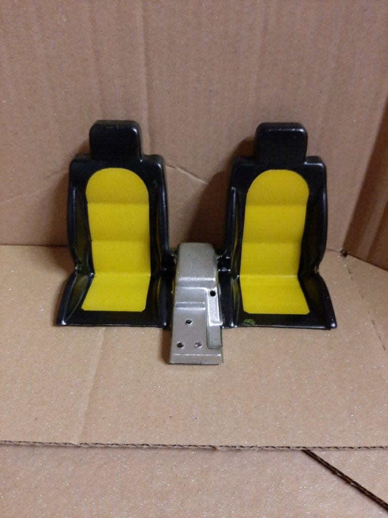

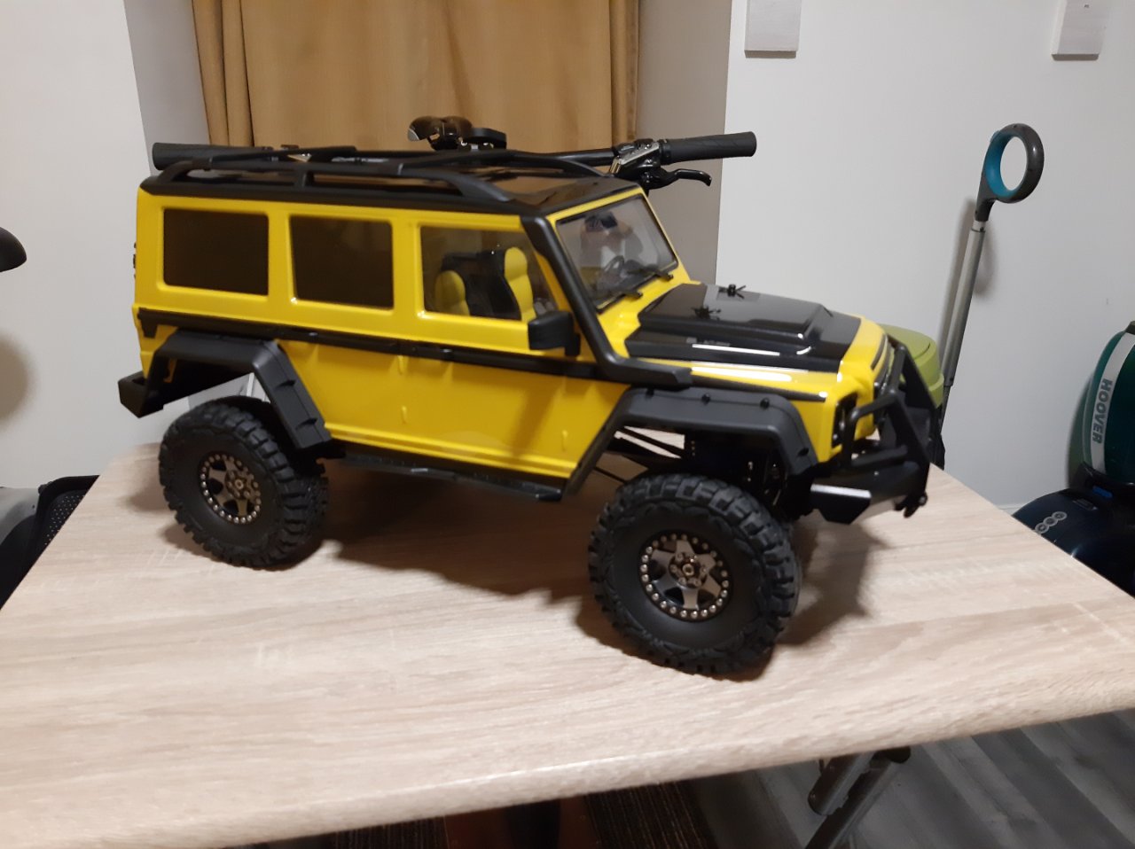

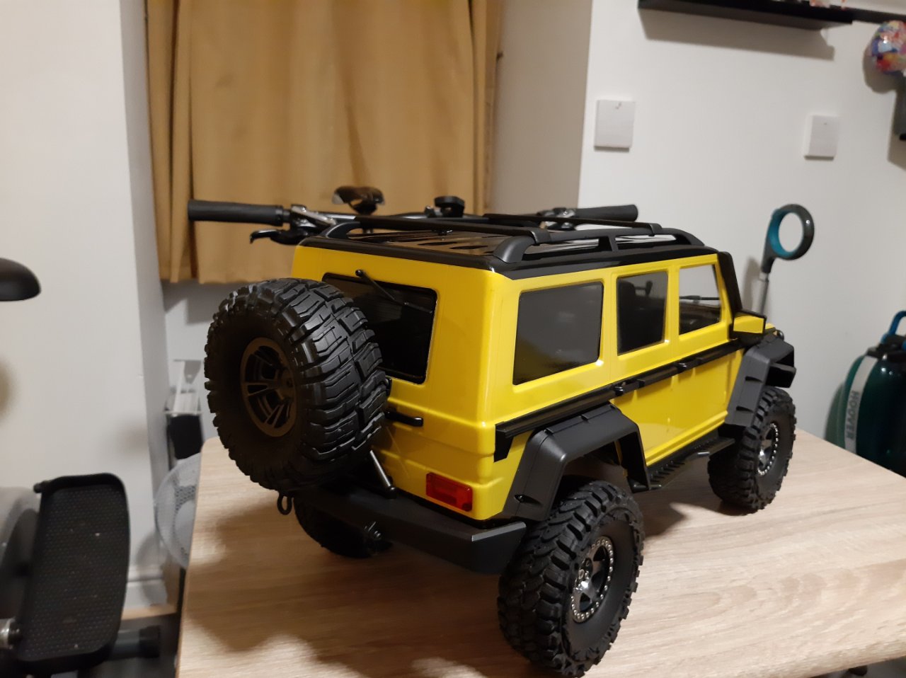

MrPeaski Posted June 8, 2021 Share Posted June 8, 2021 Here's my Hobao DC-1 Rattle cans Core RC Yellow Taxi (CR601) Backed with Core RC Metallic Silver (CR621) The black is Core RC Metallic Graphite (CR620 1 Quote Link to comment Share on other sites More sharing options...
Lone-wolf Posted June 8, 2021 Author Share Posted June 8, 2021 thank you for posting looks like it comes out well Quote Link to comment Share on other sites More sharing options...
MrPeaski Posted June 8, 2021 Share Posted June 8, 2021 It looks better in real life than the pictures. That's a fairly big shell so I used about 1 1/2 cans to get a good even coat and then 1 silver can to back it. As I wanted a black roof and a black stripe (which can hardly bee seen under the side mouldings 😐) I had to mask the whole thing off first, which took ages. There's the odd spot here and there where the masking wasn't quite tight, so a bit of faint black got under, but overall I'm happy. The black originally was going to be a carbon effect, but my practice pieces didn't turn out as I'd have liked so didn't risk ruining the shell 1 Quote Link to comment Share on other sites More sharing options...
Lone-wolf Posted June 10, 2021 Author Share Posted June 10, 2021 On 08/06/2021 at 16:58, MrPeaski said: It looks better in real life than the pictures. That's a fairly big shell so I used about 1 1/2 cans to get a good even coat and then 1 silver can to back it. As I wanted a black roof and a black stripe (which can hardly bee seen under the side mouldings 😐) I had to mask the whole thing off first, which took ages. There's the odd spot here and there where the masking wasn't quite tight, so a bit of faint black got under, but overall I'm happy. The black originally was going to be a carbon effect, but my practice pieces didn't turn out as I'd have liked so didn't risk ruining the shell i decided against the Yellow, it was a tough decision but im going to use Core Petrol blue, with black backing, i think this will contrast nice with the black plastic grill and other parts for a more scale ford Ranger look Quote Link to comment Share on other sites More sharing options...
