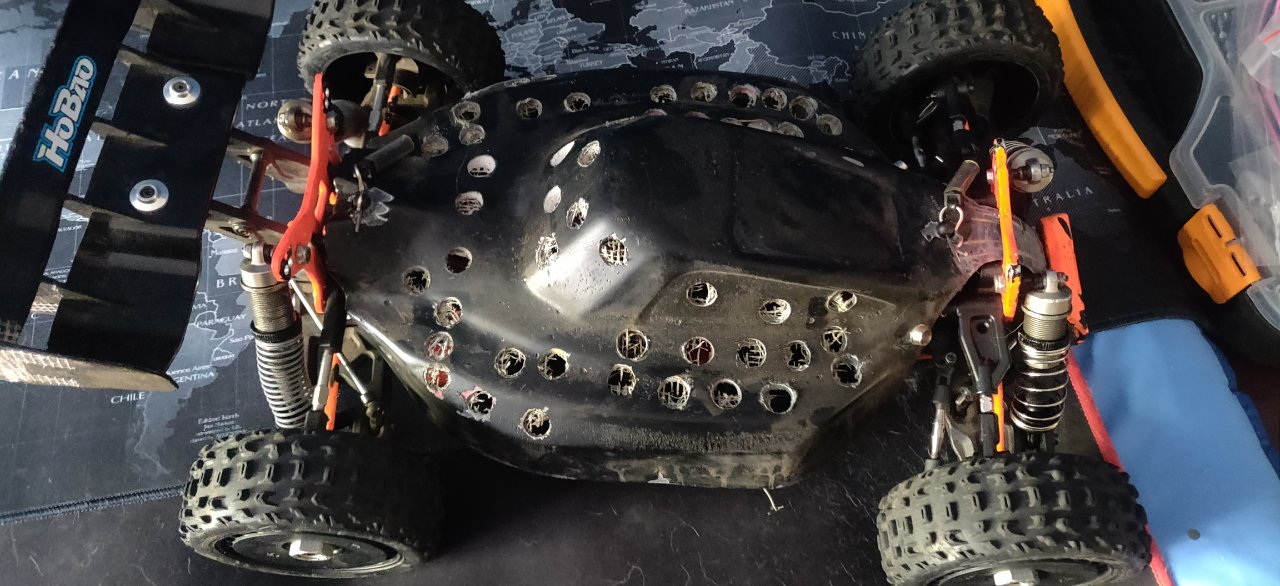

Lone-wolf Posted April 9, 2021 Author Share Posted April 9, 2021 I'm still behind this project, running it this coming Sunday to get the baseline on what it's got, but looking for a new motor either another 4068 2650 or 4274 2250 and looking at gearing, smaller spur with larger pinion there is also a possibility of 6s lipo set up at later date 1 Quote Link to comment Share on other sites More sharing options...
Redback Posted April 9, 2021 Share Posted April 9, 2021 (edited) Just bolt on a massive 30t mod1 pinion and put in a the longest biggest motor that will fit, i run 30t pinion on mine with stock spider diffs. 4274 is ideal 68 a bit short imo for 6s speed runs. You might find what you have right now works just dandy, looking forward to seeing it run. Edited April 9, 2021 by Redback 2 Quote Link to comment Share on other sites More sharing options...
Lone-wolf Posted April 9, 2021 Author Share Posted April 9, 2021 (edited) 5 hours ago, Redback said: Just bolt on a massive 30t mod1 pinion and put in a the longest biggest motor that will fit, i run 30t pinion on mine with stock spider diffs. 4274 is ideal 68 a bit short imo for 6s speed runs. You might find what you have right now works just dandy, looking forward to seeing it run. I am looking at all options, did consider getting another high c 3s pack to go 6s but motor is only rated to max 5s, but if i can get a 40T spur and then go 25T pinion on 4s with a 2650kv motor that will wake it up and get it plus 80 on paper, any ways i am charging stuff up like action cams and lipo`s and will taker the hyper and vantage for a blast on Sunday.......and it will be at a new venue with a wide loooong straight Edited April 9, 2021 by Jack Reacher 2 Quote Link to comment Share on other sites More sharing options...

GMballistic Posted April 9, 2021 Share Posted April 9, 2021 4 hours ago, Jack Reacher said: I am looking at all options, did consider getting another high c 3s pack to go 6s but motor is only rated to max 5s, but if i can get a 40T spur and then go 25T pinion on 4s with a 2650kv motor that will wake it up and get it plus 80 on paper, any ways i am charging stuff up like action cams and lipo`s and will taker the hyper and vantage for a blast on Sunday.......and it will be at a new venue with a wide loooong straight I would say for the Hobao if you want to go fast (cheaply "ish") run it on 6S with a fake Castle 2650KV : https://www.ebay.co.uk/itm/Castle-Creations-Neu-Castle-1512-1Y-1-8-Brushless-Motor-2650kV-HOT-BIG-SALE/261762482459?hash=item3cf242811b:g:q3wAAOSwfVpYnd9c Ideally though you're going to want/need a centre spool with a smaller spur gear imho. You can make one of those yourself with basic hand tools or buy one if you can find one for your model Hobao. It will give you a lot more options as well with your spur gear rather than limiting you to what fits the Hobao centre diff. Look forward to hearing how you get on this weekend. 3 Quote Link to comment Share on other sites More sharing options...
Lone-wolf Posted April 10, 2021 Author Share Posted April 10, 2021 12 hours ago, GMballistic said: I would say for the Hobao if you want to go fast (cheaply "ish") run it on 6S with a fake Castle 2650KV : https://www.ebay.co.uk/itm/Castle-Creations-Neu-Castle-1512-1Y-1-8-Brushless-Motor-2650kV-HOT-BIG-SALE/261762482459?hash=item3cf242811b:g:q3wAAOSwfVpYnd9c Ideally though you're going to want/need a centre spool with a smaller spur gear imho. You can make one of those yourself with basic hand tools or buy one if you can find one for your model Hobao. It will give you a lot more options as well with your spur gear rather than limiting you to what fits the Hobao centre diff. Look forward to hearing how you get on this weekend. The Neu-castle is rated at 4s and im not convinced it will be much of an upgrade over say gool/surpass/racestar 4068 2650, but i am looking at a gool 4076 2250kv, this is rated up to 8s, i plan to order a motor pretty soon, do i go for the 4076 Quote Link to comment Share on other sites More sharing options...

GMballistic Posted April 10, 2021 Share Posted April 10, 2021 1 hour ago, Jack Reacher said: The Neu-castle is rated at 4s and im not convinced it will be much of an upgrade over say gool/surpass/racestar 4068 2650, but i am looking at a gool 4076 2250kv, this is rated up to 8s, i plan to order a motor pretty soon, do i go for the 4076 I'm not saying ignore the motor ratings but there is a certain amount you can get away with providing it is only used for a short run like speed runs are supposed to be. That motor I linked is actually only rated up to 4S but I ran it on 6S the entire time for over 2 years with countless 100+mph runs under it's belt. It survived because I never let it get too hot and it was only used to drive up the road, complete my speed run and then drive back slowly before being allowed to cool off. I know a few speed runners who have used/do use the Surpass motors so worth a shot. 1 1 Quote Link to comment Share on other sites More sharing options...
Lone-wolf Posted April 10, 2021 Author Share Posted April 10, 2021 35 minutes ago, GMballistic said: I'm not saying ignore the motor ratings but there is a certain amount you can get away with providing it is only used for a short run like speed runs are supposed to be. That motor I linked is actually only rated up to 4S but I ran it on 6S the entire time for over 2 years with countless 100+mph runs under it's belt. It survived because I never let it get too hot and it was only used to drive up the road, complete my speed run and then drive back slowly before being allowed to cool off. I know a few speed runners who have used/do use the Surpass motors so worth a shot. so lets ignore brands for a second on paper is 4076 2250 going to be better than 4068 2650, my take on it the 4076 will have a little less speed and a tad more torque Quote Link to comment Share on other sites More sharing options...

Redback Posted April 10, 2021 Share Posted April 10, 2021 Just now, Jack Reacher said: so lets ignore brands for a second on paper is 4076 2250 going to be better than 4068 2650, my take on it the 4076 will have a little less speed and a tad more torque You want a bigger can regardless as you can use the extra motor to gear higher than you could on a 68mm lenght can. I would reccomend as before go for the biggest can motor you can, 4276 is the usall size used in 1/8th cars if you use anything smaller, lower your expectations. Quote Link to comment Share on other sites More sharing options...
Lone-wolf Posted April 10, 2021 Author Share Posted April 10, 2021 4 minutes ago, Redback said: You want a bigger can regardless as you can use the extra motor to gear higher than you could on a 68mm lenght can. I would reccomend as before go for the biggest can motor you can, 4276 is the usall size used in 1/8th cars if you use anything smaller, lower your expectations. cheers for the reply, but a 4276 is way out of budget £120-180 is not an option, will go with 4076 Quote Link to comment Share on other sites More sharing options...
Redback Posted April 10, 2021 Share Posted April 10, 2021 (edited) 6 minutes ago, Jack Reacher said: cheers for the reply, but a 4276 is way out of budget £120-180 is not an option, will go with 4076 You know your getting an undersized motor, you also know your wanting fast speeds, so why not just wait a little while and get the correct motor for the rig so you get the speeds your aiming for, buying 2 motors is more expensive than one correct one. Not sure were your getting 120-180£ from. The motors are 83£https://wheelspinmodels.co.uk/i/264665/ Edited April 10, 2021 by Redback 3 Quote Link to comment Share on other sites More sharing options...
