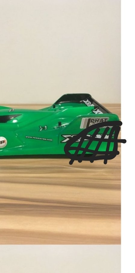

10 minutes ago, Alex97 said:
Looks good, I've got a similar build.
I sopke to the guy at Phat and he said the best results from the body is when they are cut back like below.
Yeah, ive done that with another shell (currently mounted to my Spada)
Can try both then and see what works best.
