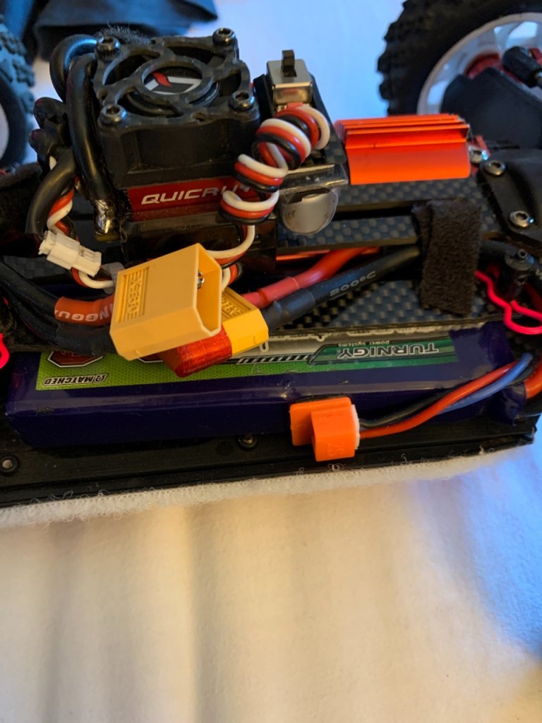

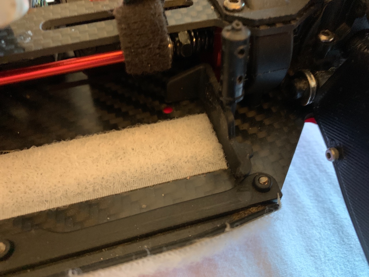

bertberr Posted December 24, 2020 Author Share Posted December 24, 2020 Ok I'll do that. Out of interest do you know the battery tray dimensions, and what the max depth / height can be fitted under stock body? Quote Link to comment Share on other sites More sharing options...
Ag100 Posted December 24, 2020 Share Posted December 24, 2020 25 minutes ago, bertberr said: Ok I'll do that. Out of interest do you know the battery tray dimensions, and what the max depth / height can be fitted under stock body? It’s actually more the top deck that restricts the battery height, I run the Turnigy Nanotech 2200 mah 2s and a Turnigy Nanotech 2200 mah 3s both fit fine. https://hobbyking.com/en_us/turnigy-nano-tech-2200mah-2s-35-70c-lipo-pack.html?queryID=a249eb465852bafc05796e73cb8ca9f0&objectID=30638&indexName=hbk_live_magento_en_us_products https://hobbyking.com/en_us/turnigy-nano-tech-2200mah-3s-35-70c-lipo-pack.html?queryID=666dcefe6873761f08c267e037728ed8&objectID=30640&indexName=hbk_live_magento_en_us_products others have used this hard pack https://www.dms-racing.com/index.php?option=com_virtuemart&view=productdetails&virtuemart_product_id=28650&virtuemart_category_id=15 Quote Link to comment Share on other sites More sharing options...

bertberr Posted December 24, 2020 Author Share Posted December 24, 2020 Thanks for the pics, that puts my mind at rest, its those 35-70c 3S packs that I currently have four of without a home, hence my desire to go 3S & circa 3000kv. Do you have the buggy as well as the truggy? If so thoughts between the two? I want something I can sling in my rucksack and take on a walk with the family, and use (carefully) at the local skate park. Quote Link to comment Share on other sites More sharing options...
