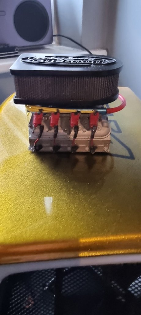

Then.. Fitted the one off scale motor and cut and mounted the body ready for paint.

On 26/11/2020 at 23:51, YetiScore83 said:
Yes, sorry all I got distracted and then sort of lost interest in it. Its virtually done, just been stuck on the final 1% for the last few weeks, need to find thr motivation to get it done.
Since the last update, the Hot Racing shock caps and toes, Traxxas TiNI shafts and Blue anodized bodies arrived. So build up the shocks with firmer Green and Blue springs, I need to reevaluate that though as it looks to be a little too firm now in the front.
I Also swap out the front CVD for rhe new Hardened steel versions from Vitavon, as well as being a tougher material they are thicker especially in the dogbone necks, so should be super strong!
The 1650kv motor is in and new gearing 55/31, I Alos change the Rearopen diff cup to the aluminium one. All fired up and running nice and smooth.. Result.
Then started to tackle the minefield of wiring in this thing. It has the standard traxxas led kit.. But that is not compatible with the Hw max 6 Esc. So I have installed an old broken Vxl6s esc as a power source for the lights.. Amazingly is works.
Functional rear fan cluster wired up too.
Then I sent the body off for paint.. This build was a tribute to a trophy truck "Big Oly" not a scale replica just a tribute, but I'm pleased how thr body came out.
The 1%.left to finish... Wire up and mount the front Halo lights and rear tail light, install the interior and then a full shake down.
A few photos for you..
