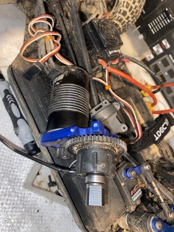

I managed to pick up one if these for £100 it's well used and needs a clean apart from broken roof panel it's all working great.
First job was to change centre diff fluid. I went with 200k to see what it's like. The screws holding the diff and motor mount etc have way too much thread lock on from factory so managed to strip a few then good old dremel to help get them out. It's in bits now waiting for cnc rear suspension holder as well as few screws and bearings.
While it's in bits I thought I would upgrade servo to 25kg and also program esc. Two questions 1 I know the esc is hobbywing but does anyone know which box is used to program it as so many different ones.
2. How do you tighten the servo saver
