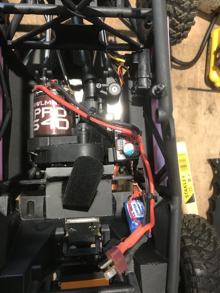

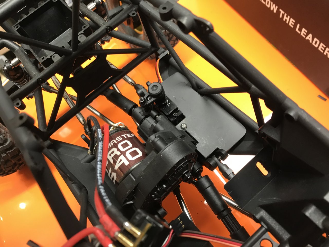

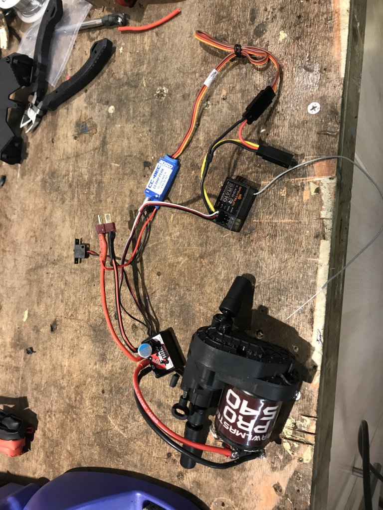

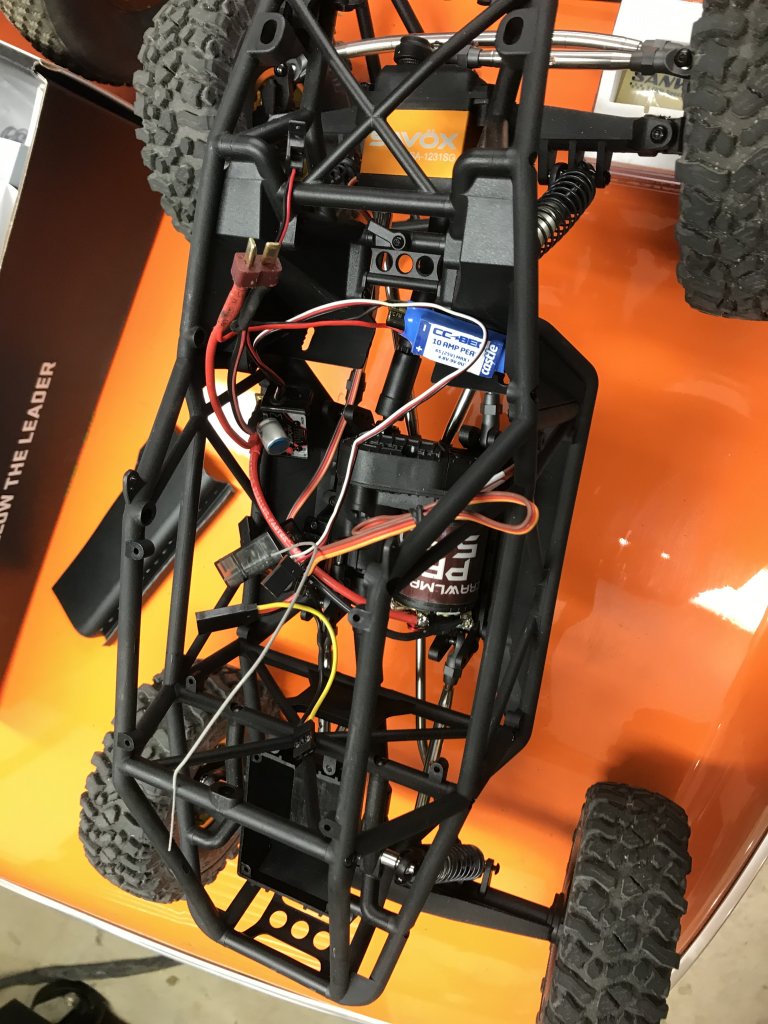

Next it was Electric’s.... I’d looked at a few options and settled with an old Tekno FXR I had new in package and a Holmes Hobbies 16t Crawlmaster Pro. I absolutely love these motors, the low down control and resolution is awesome👍.
As I was going to be running it on 3S and had a 6v Savox servo sat about I put a BEC in... There was also the DIG servo consideration which I fed via the BEC also, RX was fed from ESC.
As my considerations were towards ultimate COG I didn’t want to put them in the allocated locations....  I figured I could get them on the skid somehow... Especially as I had an FXR which are tiny...
Lorra Wires!

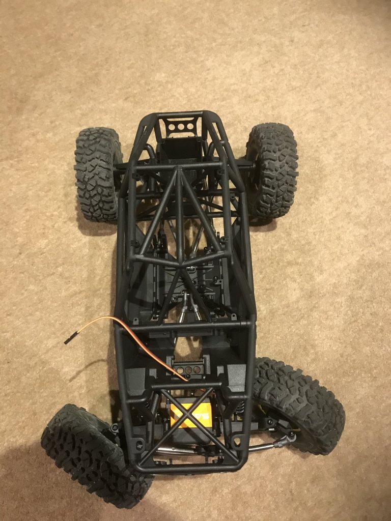

And where to put it all...
Ooh... Perhaps I could hide it all!!
This could work!!!

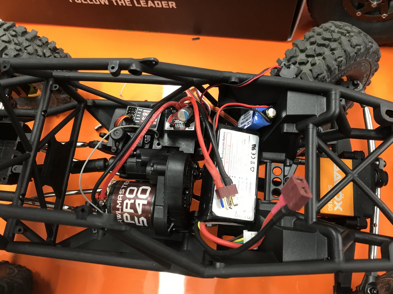

Rough positions for now...

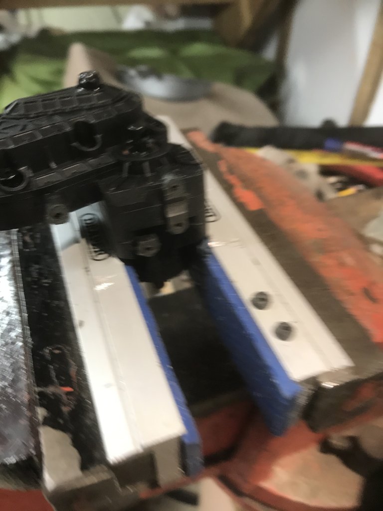

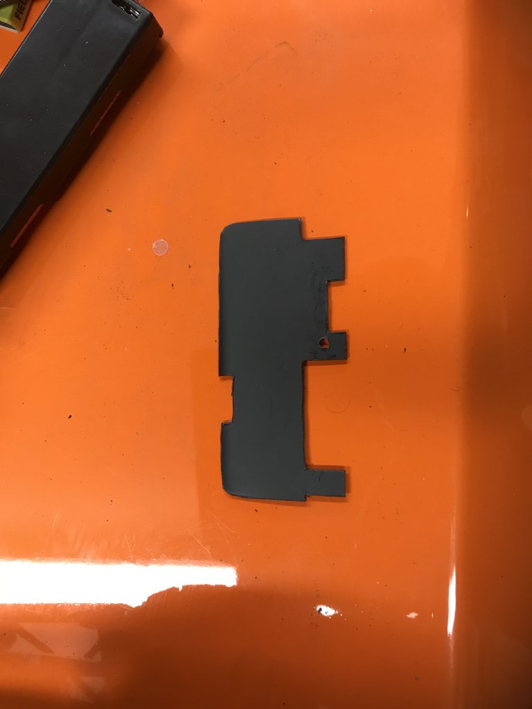

So, some of you may have noticed that battery in an odd place.... Well, I wasn’t happy with how high the battery was placed in the model and as I’d be running small batts only I could see a much lower solution ( which granted I may have noticed an issue with later on!!! )...
Cutring...
Gluing
Voila!!

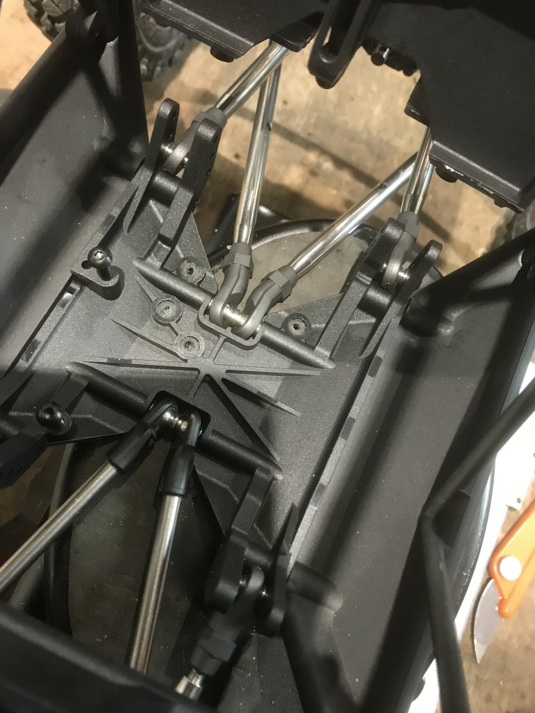

All was easy man. Don’t know what all the fuss was about... The only point of note was you have to read the manual! Oh, and one instruction said 18mm screws when you only had 16mm left or something like that...
Just done electrics.... Will continue putting the build down after feeding  and amusing the pupil... Currently homeschooling! 🙈

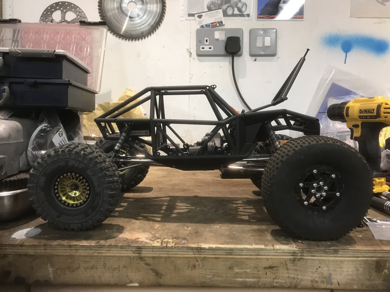

Whilst messing around with the links a bit I found  some bent Ti units on the uppers of my Yeti project that were a good size. These are ever so slightly longer than standard , something I’m  cool with as the front links will be slightly shorter when tuned for caster...
Ooh, fancy rear clearance ... Them wheels look funny mind!! 1.9 vs 2.2

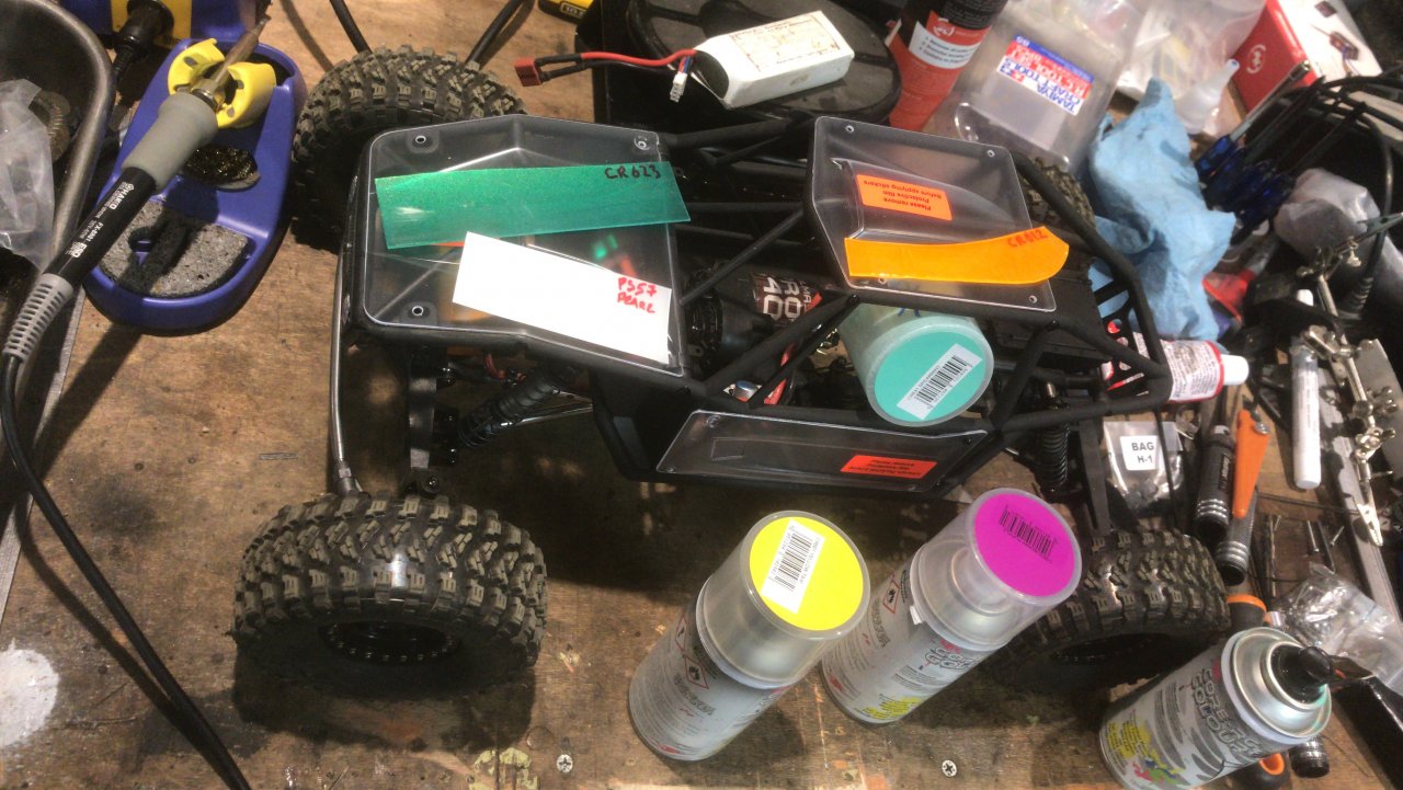

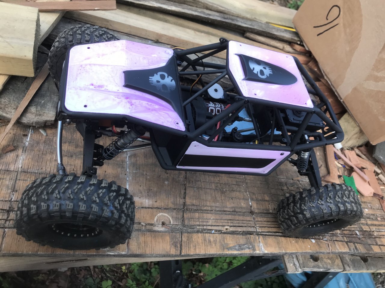

Next was the body... I wasn’t sure if I’d run all the panels due to weight considerations but figured I’d start at the beginning....
I really wanted to go lairy with the paint for some reason - as I normally play safe - and was considering all sorts of colour combos! For some reason I was getting drawn to Berry Purple and Taxi Yellow! 🤢
Soooo many choices...
But in the end my safe side got the better of me and I decided with a pearl white and Matt black mix with some highlights....

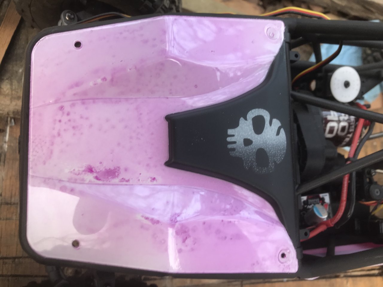

Then my pearl reacted with something on the lexan... I probably didn’t let the solvent cleaner dry enough... Dunno...
After having a quick go at wiping it off I just couldn’t be bothered and though sod it!! So I backed the funky Pearl with some Berry purple... But it didn’t show... So I put more on... then a bit more.... hmpf... Not showing much... Then I backed it with white..... And watched the whole thing intensify as it was drying!!
Wowzas!!!?? Where’d that pink come from!?!
Crazy Bonnet tie dye effect!..
The pink was growing on me!.. But it still lacked something....
Some stickers helped

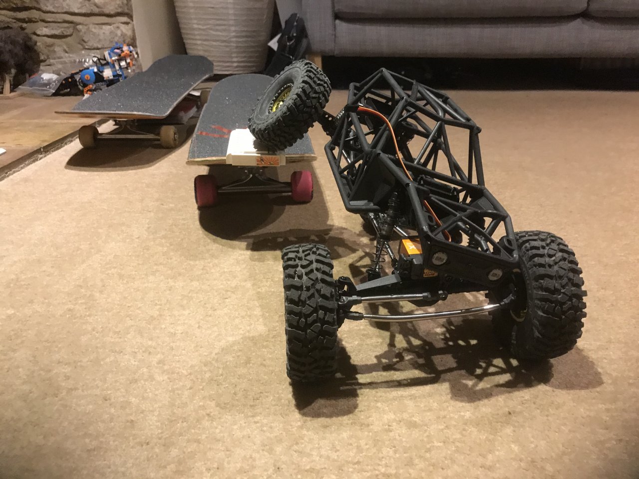

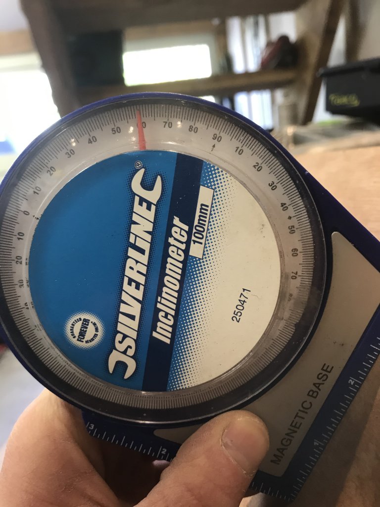

Then started having a play with the geo and links... Built a quick ramp to monitor progress... ( Bare in mind ascending is not the only forte needed but fun to see)
On 2.2s So actually a higher COG than it would normally run  ( Edit - just remembered I had zipped down the front suspension to try mimic future stance / weighting effect - should still get better than this mind)
That saw 60 degrees, which to be honest with no weighting at all yet or proper tuning is pretty respectable ..
Edited by stimpy

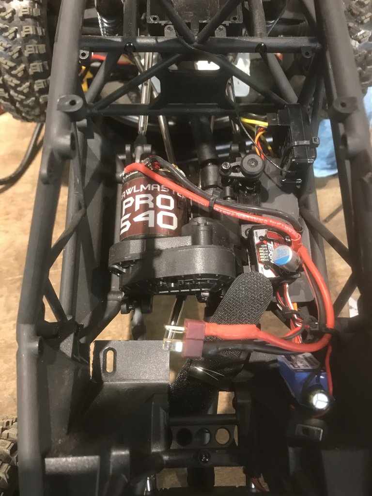

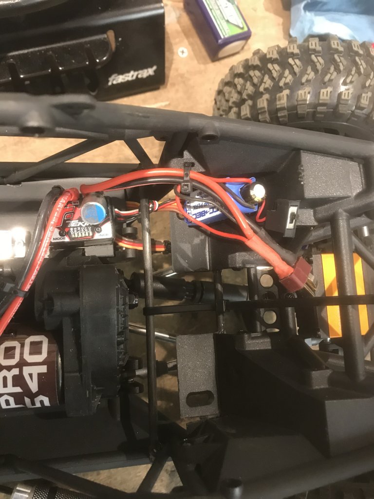

7 minutes ago, Oh How Original said:
That's a nice neat elecs install :D
Took a while to figure out!!
I could actually get the BEC now at the back of the skid behind the receiver but as I’m considering a 12v servo I’ve not bothered....

I have also found my battery mount to be a bit of a faff! It’s ok as I’m not running the interior but with it in I’d be upsetting folk around me with rage!!. So I am going to redesign this so the battery sits between the bulkhead side plates nice and low. It will sit there battery in a better position for COG as well as aid my mental health 🤪🤓
This design is only functional with small batteries. And as my interest lies in Crawling performance only it fits the bill perfectly. Currently I run 850mah packs but will test some slightly larger ones at some point 👍

That’s a cool looking spot for a cool looking rig, and even the pink is starting to grow on me...reminds me of strawberry Fruitella! Remember those?
What fancy foams are you thinking - Crawler Innovations?
I’m gathering parts for my rebuild and Pitbull Growler, or possibly the Berserker, along with CI foams are top of my list for tyre choice.
