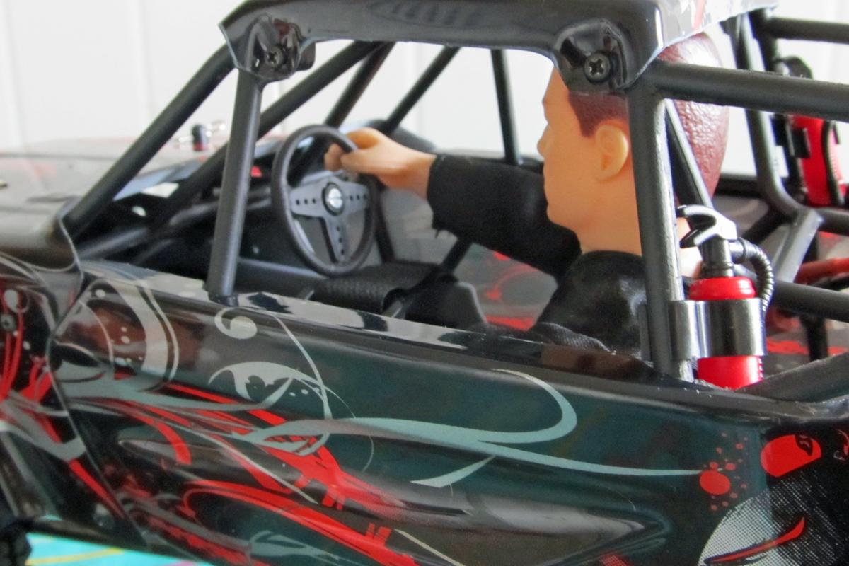

Hi everyone,
I've recently bought the RGT version of this car called the Rockhammer. At first I was a little disappointed with the out of the box performance and certain aspects of its looks so decided to try a few things. Firstly my version of the car came with a silver coloured cage which didn't suit the look I wanted. However, I have a buggy made by HSP which is also the OEM of the Rockhammer. Luckily the cages are identical so the silver cage of the RH was swapped with the black one of the buggy. At the same time I removed the moulded drivers because I didn't like them either. This is a crawler not a racer!
I felt the suspension was a little too hard so I removed the pre-load rings which made an improvement. I was disappointed that the tyres were glued to the rims, therefore making changes to the foam inserts ( which I think are too hard) or adding wheel weights problematic without lots of effort. I do have some slightly smaller, softer and grippier wheels/tyres which I may try at a later date. Until then I found that drilling another air vent on the inside of the rims allowed the air to escape a little easier, allowing a little quicker air flow and subsequently more flex from the tyres.
My final mod has been the most work so far though but also the most satisfying. It's still work in progress with more to do but I'm pleased with the result. Essentially my model is now a single seat 1/6 scale crawler. I've included a few very hurriedly taken pics to give the general idea.
