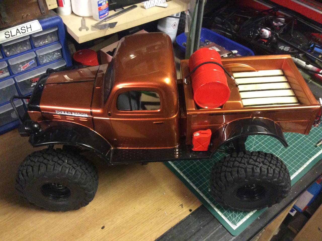

Decided to change the look a bit...not a fan of the skull thing...but I think it looks more a hobby vehicle now.
Guess having to spray the outside will catch up with it but its ok for now.
I also changed the way my Mauler looks but in a much larger way
