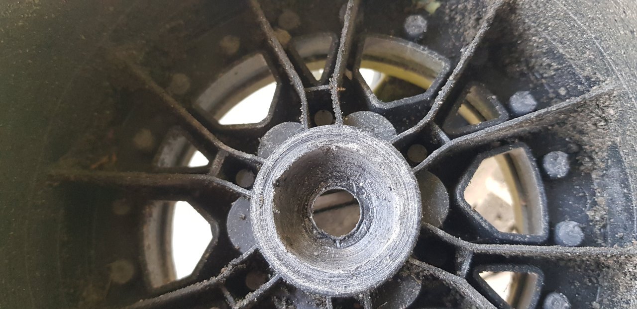

How and why did this happened?!!
 Heavy wheels, too much power, loose wheel nut  and a driver not paying attention is probably a good starting point
Ok lets analyze this:
Heavy wheels? Tho they are one of the heaviest in the market, but majority of "light" ones are 30-50g lighter - so i would guess many of you (ones not using Traxxas original wheels) had this problem? How did you solved it?
Too much power? Should i gear up (currently stock gearing) so i would trade torque for speed to avoid this problem in the future?
Loose wheel nut? Tho sometimes they do come loose - still working on solution (atm just using locktite) - how do you deal with nut loosening? But this wheel i had hard time unscrewing - it was super tight.
Driver not paying attention? To what?
P.S. Turn off this passive agro mode or just off if you have nothing helpful to say. Cheers!

Was the wheel definitely seated correctly when you last fitted it? I can't see any reason for this to happen, even with heavier boots. Only reason I can think of is a loose nut or misaligned hex that was mashed on with force.
Good question... Tho i don't think it is possible to screw the bolt if the wheel is not seated - almost no threads showing... Ill try gearing up and replacing  7756 with 7756X. Also, would washer help with nut loosening? Using loctite every time I put on wheels is ridiculous...

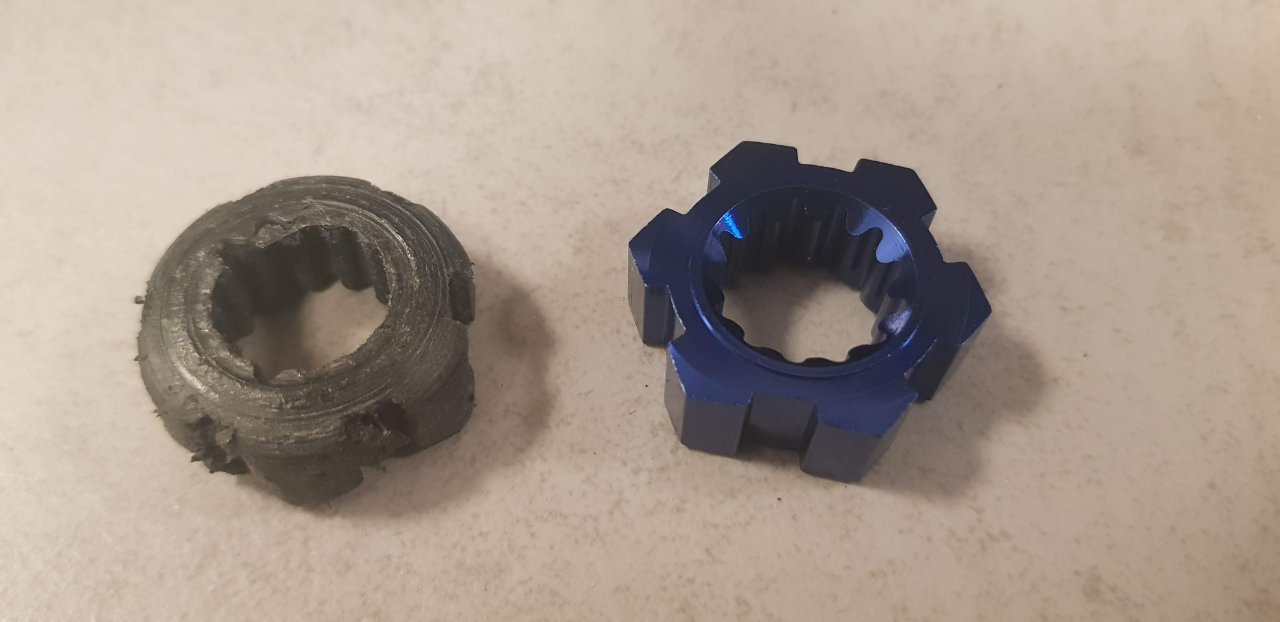

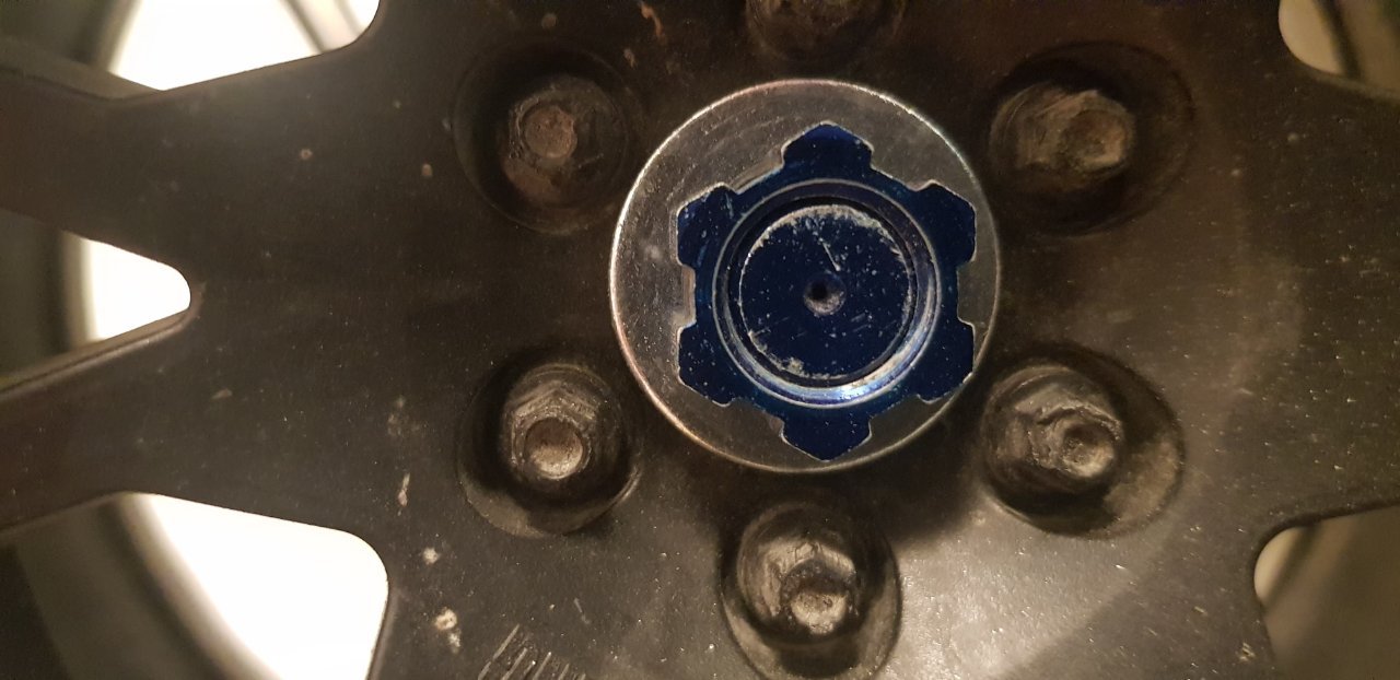

On 29/05/2022 at 16:37, Tug said:
Threadlock is standard practice, but stick to blue, not red as that's very strong.
Apologies if I'm stating the obvious.
I think this solves the loosening issue 🙂
And a comparison of damaged vs new/upgraded hubs.
