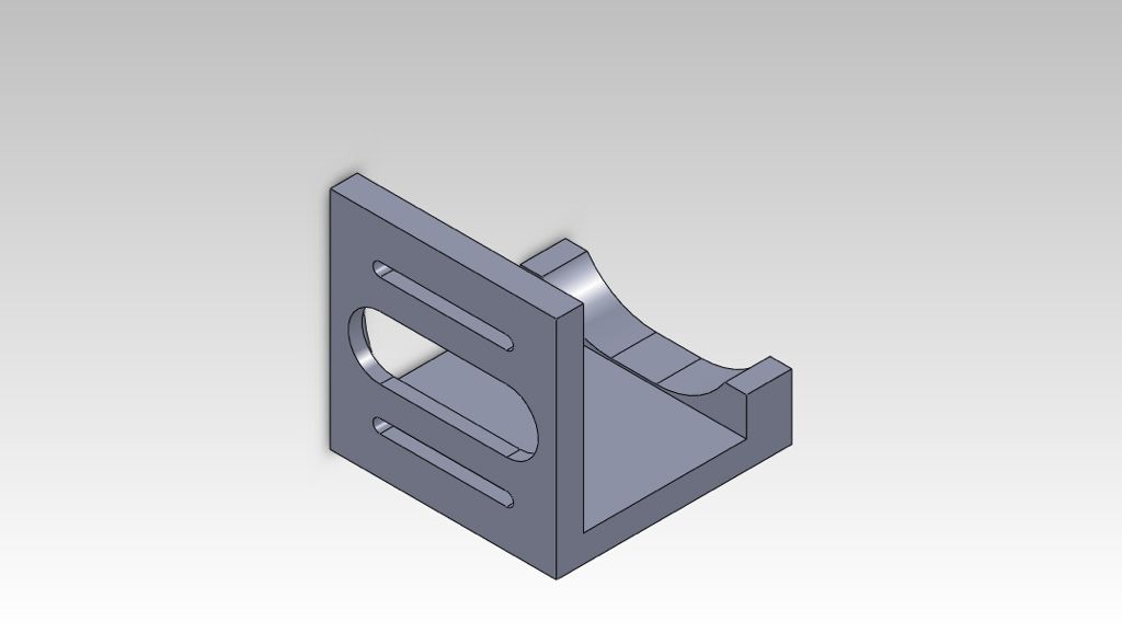

ashleysmith Posted June 16, 2012 Author Share Posted June 16, 2012 Motor mount design as promised only a V1 so I will be changing features Quote Link to comment Share on other sites More sharing options...
Ziggy122 Posted June 16, 2012 Share Posted June 16, 2012 Lighten it up? That mounts gonna weight abit like that Start to drilling somes holes i think Ziggy Quote Link to comment Share on other sites More sharing options...
ashleysmith Posted June 17, 2012 Author Share Posted June 17, 2012 Lighten it up? That mounts gonna weight abit like that Start to drilling somes holes i think Ziggy The mount I have isn't far off that and doesn't weigh much, I'll find out the weight tomorrow (I have a materials edit within the CAD package I use Quote Link to comment Share on other sites More sharing options...

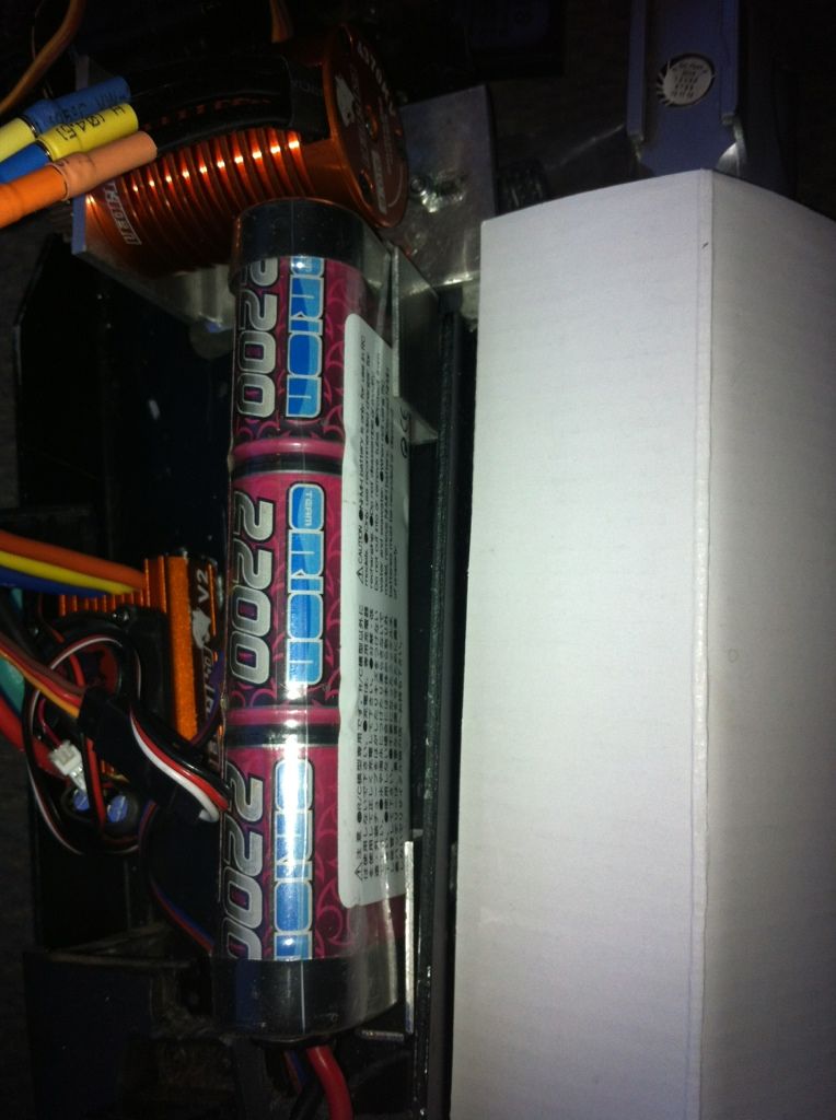

ashleysmith Posted July 22, 2012 Author Share Posted July 22, 2012 Update.... Gone back to the black chassis, the Alu used in the silver chassis was a bit too soft, so ive adapted the black chassis Also gone brushless too :-) Cut a little bit more from the upper deck section, to allow the battery to fit Will be making some battery holders from sheet metal tomorrow :-) Quote Link to comment Share on other sites More sharing options...
ashleysmith Posted July 25, 2012 Author Share Posted July 25, 2012 Battery tabs in place :-) need to make a slot for the velcro Quote Link to comment Share on other sites More sharing options...

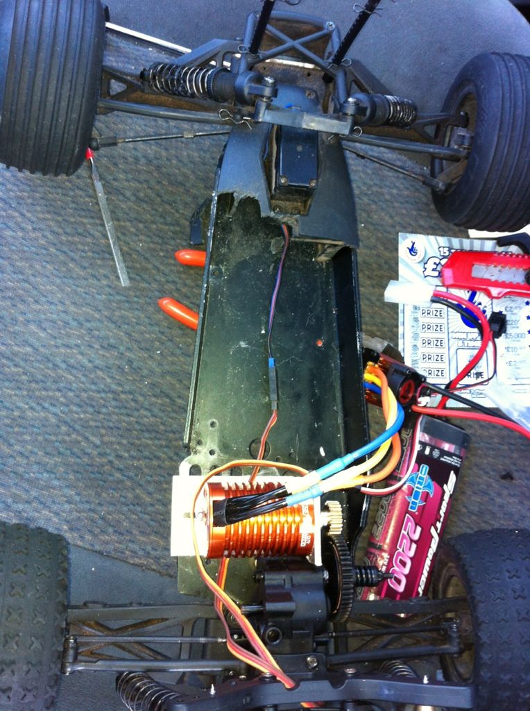

rutteger Posted October 18, 2012 Share Posted October 18, 2012 Bought this, thought I'd update Ashley's thread rather than starting a new one given I'm not sure as to what my plans are with the car. Installed an ESC and motor and got the car running. Also tidied some of the existing work. Seems to run well enough, may have to adjust the motor mount at some point and gearbox fixing. Think the gearbox and rear shock tower (Firestorm afaik) fitted sits higher than the stock Rush items and as such put the rear end geometry out slightly. Quote Link to comment Share on other sites More sharing options...
rutteger Posted October 22, 2012 Share Posted October 22, 2012 For a project I intended to spend zero time on I've ended up spending some time on it. Ended up modding the chassis slightly to ensure the gearbox could sit flush. Had to ease out the recess for the Rush gearbox, guess the tab on the Firestorm box is larger. This allows the gearbox to sit flush. Which then allows the rear suspension to sit far more sensibly. Like this. Yes, I know I should've stripped the chassis to stop the filings getting everywhere... Also used bigger bolts on the motor mount and adjusted it slightly. Everythings seems to be holding well enough currently. Quote Link to comment Share on other sites More sharing options...
