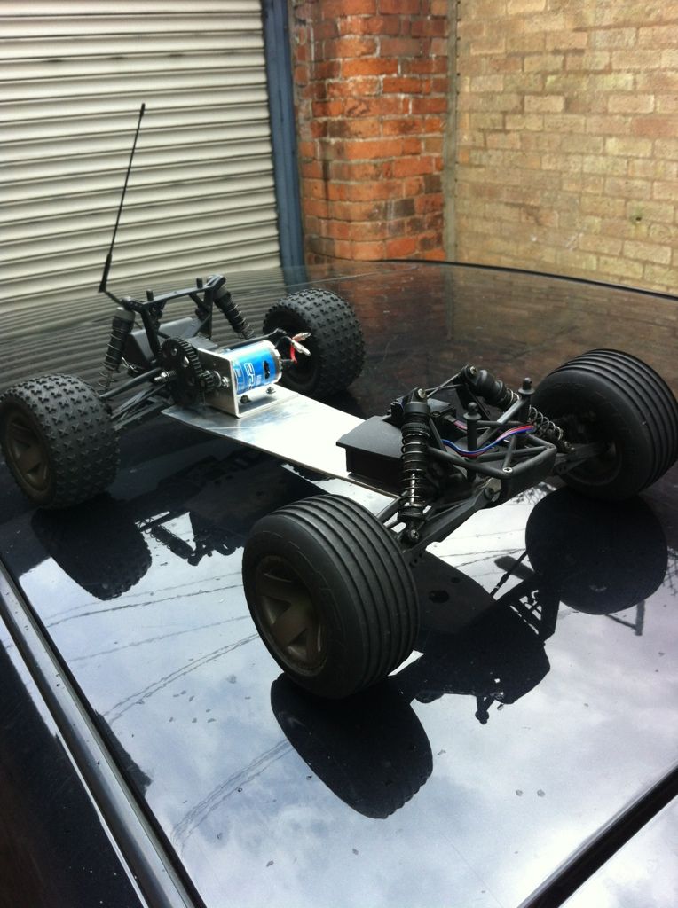

Bought a rolling chassis from micksid

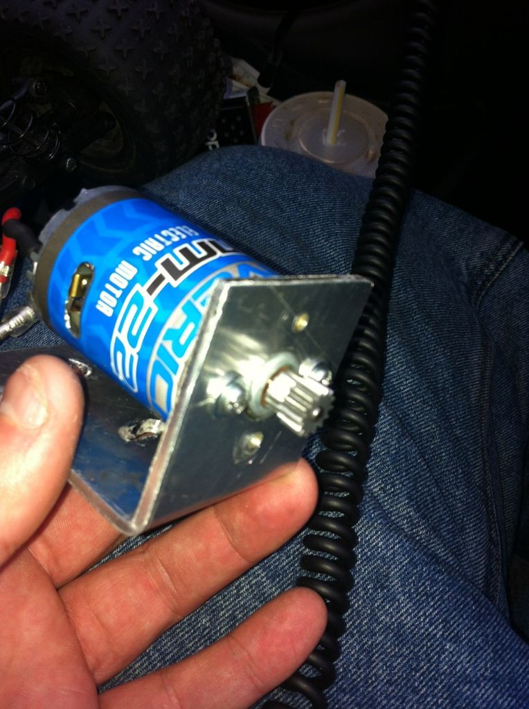

And I have bored put the hole on the motor mount to fit the motor...
Next up is fitting the pinion, battery tray and electrics, modding the shell a little bit and then bash
Something which i never got around to was making a chassis brace for it, which goes from the two holes on the rear gearbox to somewhere on the chassis, you could always make it out of some threaded bar and some rod ends, will make the chassis nice and stiff then, esp if your bashing it:)

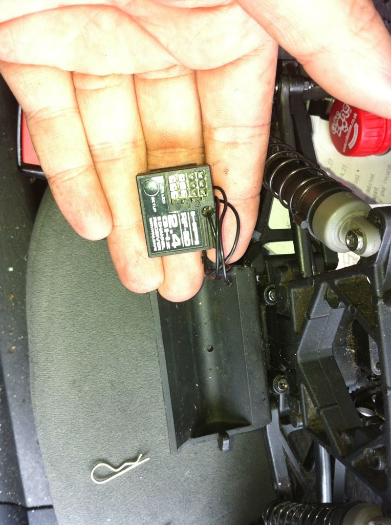

I was thinking of hiding the rx in the battery box at the back... Keeps it protected and more space on the chassis....
It seems pretty stiff ATM but... Your right it will need reinforcing, it's being sneaked into the house tonight, so I can CAD some parts up and have a computer model too :-)
Exactly what i was going to do, its ideal having the box on the back, if you have room though pack the box with some sponge to protect the receiver from bad landings.

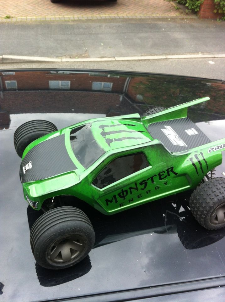

Are you going to fit a spoiler to it also? Would look well with that shell, hellfire wing mount would fit nicely i think, and a ansmann high downforce wing. :)

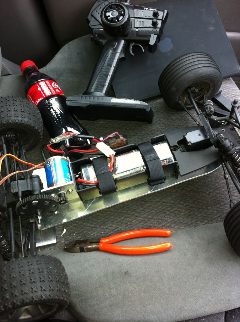

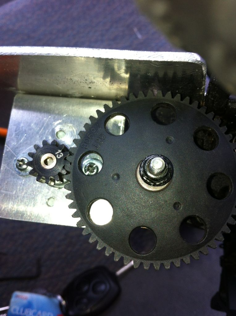

Well afteri managed to order the right pitch pinion but with the wrong fitting, a quick trip to my engineering friend and we solved the problem... A 2mm copper insert

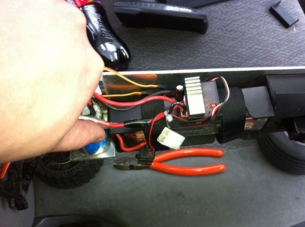

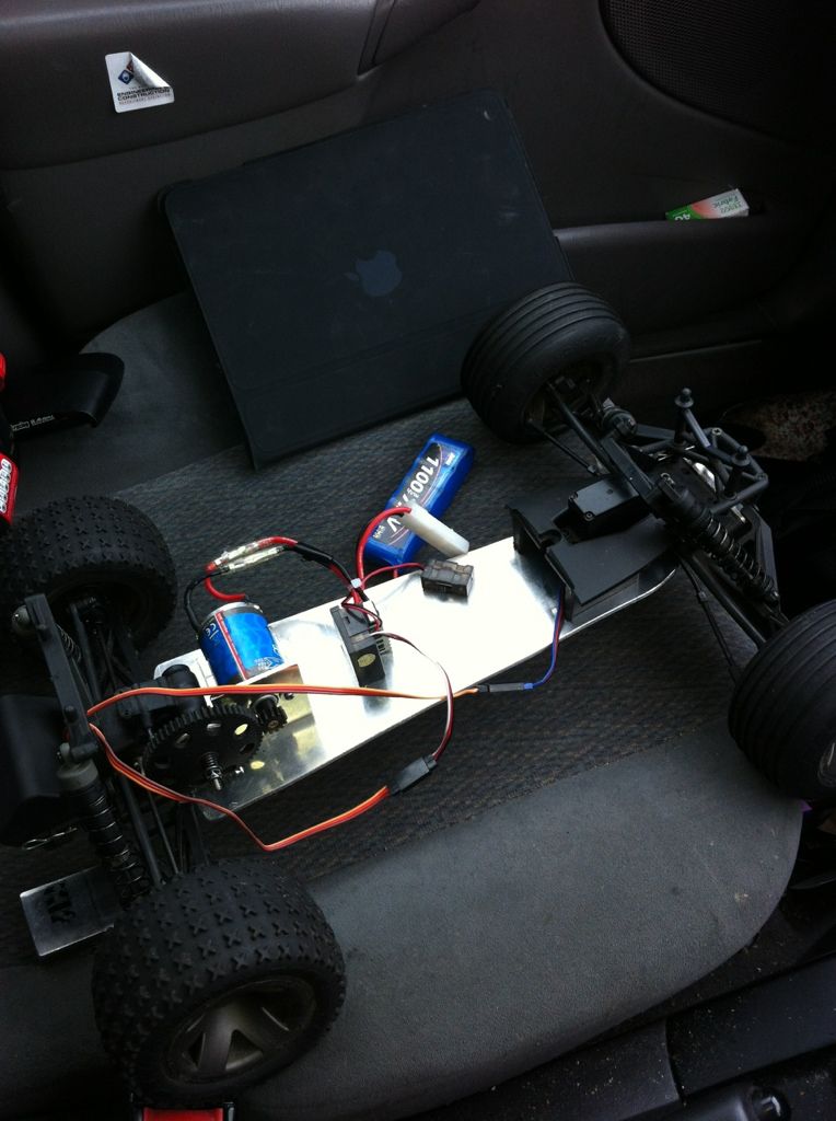

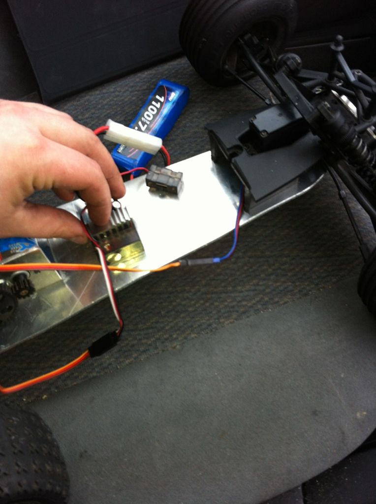

Attached a battery quickly to test it and boom, it's alive
i switched my motors round so the buggy is running the 19t but it doesnt seem much faster... so i'm thinking new esc for now... might see if i can pick up another LRP A.I as its pretty good on the drifter... gonna mount the shell next (on the chassis that is)
