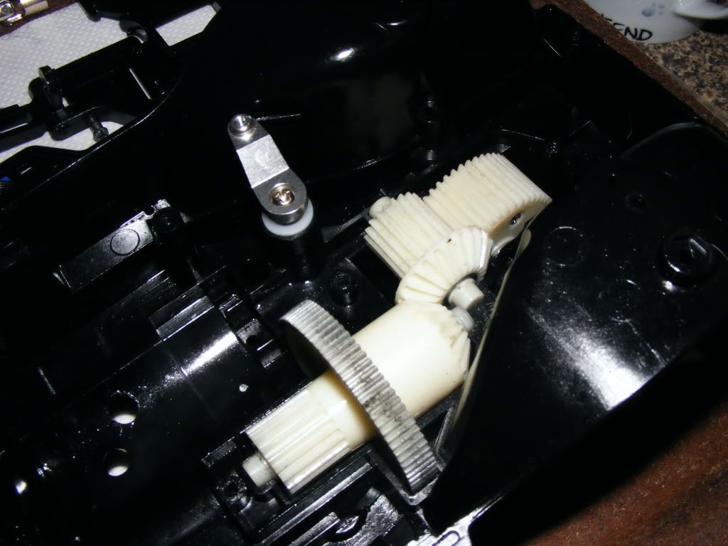

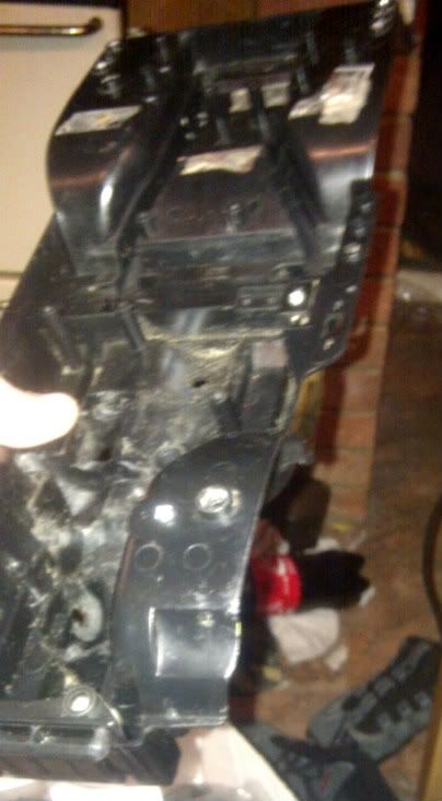

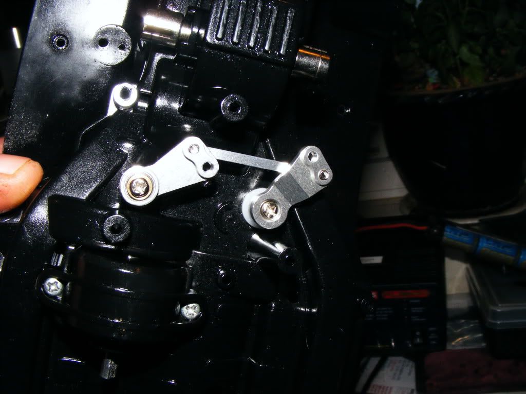

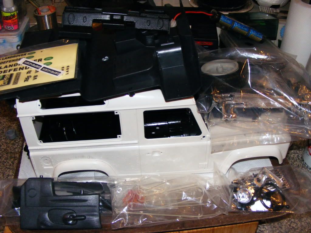

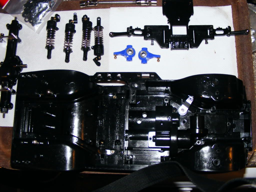

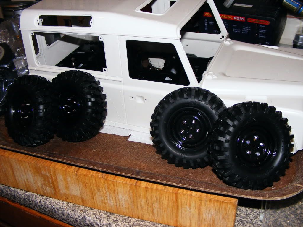

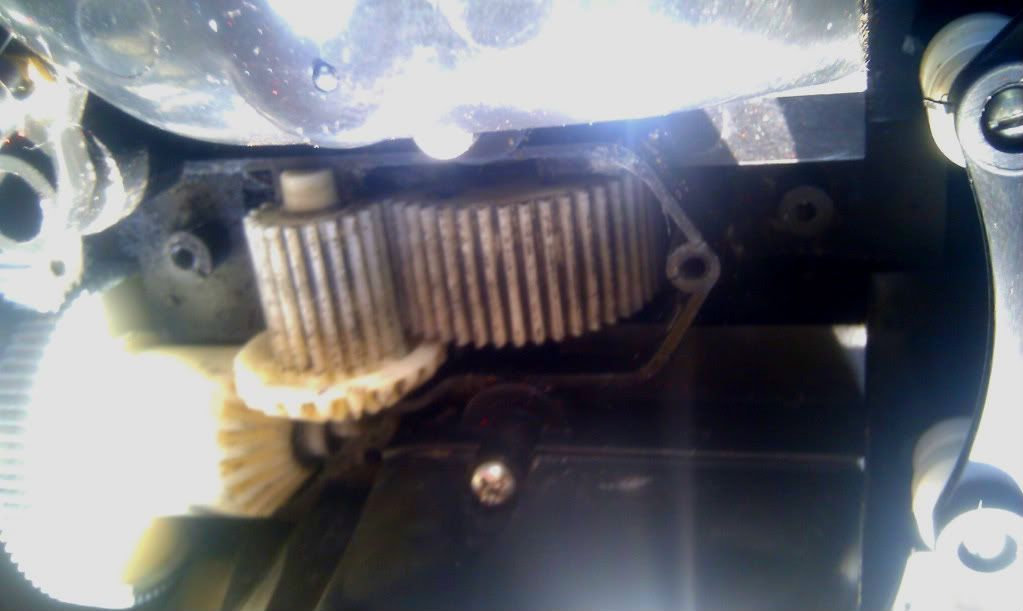

bbadger Posted April 4, 2011 Share Posted April 4, 2011 UPDATE When I recieved the car - it is safe to say that it had seen a lot of use - certainly provided many hours of use, and a few mods along the way. So I set about giving it a bit of a clean. Stripped down to individual compoents - cleaned and re-assembled - whilst I was at that I swapped out all of the tamiya nylon bushes and replaced with bearings. As it is now - As I need to extend the wheelbase, and the old tamiya links had been adapted to attach tie-rods, I ordered some brackets for the rear axle (on far left you can see them attached) and hopped up the steering to all aluminium with ball bearings - moves virtually friction free now. Plan is for this week to attach the tie rods and build some brackets to mount the body. The shell is amazing, and has every single extra you could ask for ! got some of the annsman wheels that are clearly based on landy wheels, The rear diff is locked, but I have removed all the blu-tack from the front difff and re-built that (not an easy job!) as it is not going to be a rock crawler and I want some realism in off road driving - I am thinking of unfixing the rear diff, but would need to buy the planatary gears for that, I have a 55t motor and a rock crawler ESC ready to go in. Only thing left now is the prop shaft - as I need to move the rear wheels back, the existing one will not quite reach - as soon as I have the exact measurments I will begin to search for one - Suspect it may have to be an axial prop at the moment, - which gives me a good excuse to hop up my scx10 and use one of the props currently on that! Will post more once I have it assembled. Then the big question ia - What colour? Quote Link to comment Share on other sites More sharing options...
53HRA Posted April 4, 2011 Share Posted April 4, 2011 Looks great mate One thing to watch out with on them Landy shells....I found sticking the bits of plastic down to be a right pain! Once she is sprayed up,place the windows,lights and whatever and melt the little tabs from the inside of the shell, with a soldering iron - They go rock soild If you glue the bits in,they end up falling out or makes a mess As for colour heres my old one: It was a light kind of blue,which i liked but i was stuck between that and a sandy kind of colour.... Spray paint: The halfords 1:1 car paint is the best stuff,does wonders Quote Link to comment Share on other sites More sharing options...
bbadger Posted April 4, 2011 Share Posted April 4, 2011 Looks great mate One thing to watch out with on them Landy shells....I found sticking the bits of plastic down to be a right pain! Once she is sprayed up,place the windows,lights and whatever and melt the little tabs from the inside of the shell, with a soldering iron - They go rock soild If you glue the bits in,they end up falling out or makes a mess As for colour heres my old one: It was a light kind of blue,which i liked but i was stuck between that and a sandy kind of colour.... Spray paint: The halfords 1:1 car paint is the best stuff,does wonders Thanks for the tips! As for the colour, I am also torn between that shade of blue (the original colour of my Series III) and the sandy colour - which was the colour of my first ever Landy! Quote Link to comment Share on other sites More sharing options...
Gaz! Posted April 5, 2011 Share Posted April 5, 2011 have a look at the toureg propshaft. it the same cc01 chassis but longer wheelbase. cracking body though, wish i never sold mine now....... Quote Link to comment Share on other sites More sharing options...
bbadger Posted April 5, 2011 Share Posted April 5, 2011 have a look at the toureg propshaft. it the same cc01 chassis but longer wheelbase. cracking body though, wish i never sold mine now....... anyone know the length of the touraeg prop? found some for sale but cannot find the dimensions? Quote Link to comment Share on other sites More sharing options...
Cheese85 Posted April 18, 2011 Share Posted April 18, 2011 (edited) well, i dont know the shaft length, but it makes the cars wheelbase 10mm longer, if that helps Edited April 18, 2011 by Cheese85 Quote Link to comment Share on other sites More sharing options...
bbadger Posted April 19, 2011 Share Posted April 19, 2011 It may do. TBH have not had a chance to carry on with this for a few weeks, I still do not know exactly what length I require. As soon as I get my finger out I will update and let you know how I get on re the prop. shaft Quote Link to comment Share on other sites More sharing options...
XV Pilot Posted May 9, 2011 Share Posted May 9, 2011 Hi! Not sure of the length, but if you want to order one the part number for an MA7 Touareg propshaft is 4135050 - hope this helps! Quote Link to comment Share on other sites More sharing options...
