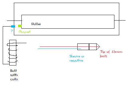

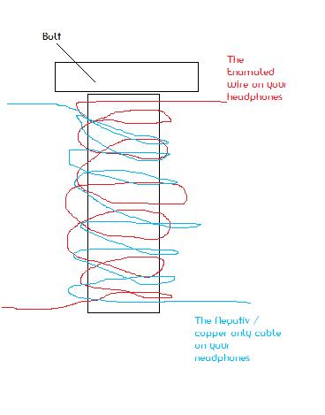

ok i get the concept of this i worked a fair amount of magents and transformers what i wanna know it how you link it to head phones do u link the enamled wire in the headphones to one of the the coils ? post-15201-127290199714_thumb.jpg
from this badley drawn rougth template maybe 1 of the 2 of you will be able to shed some light :) PS i can draw this bigger if need be
if what i think is true then u chould use the other headphone for the 2nd roller then ... geek at heart :(

Ok ill try to explain.
First they are stereo headphones so each earpeice has 2 wires (except in some cases where they share a ground) i have only used one earpeice (2 wires) one wire to each side of the coil.
Wire1 Wire2
LOL diagram in asci :)
Because you can use stereo (2 channel) input on the line-in it is possible to do 4WD however the SimpleDyno software does not support that yet
The basics of how it works are whenever you pass a magnet over a coil a small amount of electricity is produced when this is attached to the line in a detectable signal is produced each time the magnet passes the coil and the software is able to calculate RPMs from this
