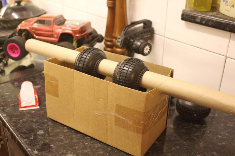

To begin with cut a V groove in each end of the cardboard box, deep enough that the tube will sit comfortably in it. Put a tyre over the tube, and sit it in the box.
Posted Image
Doing this helps to hold everything in place when you start handling the gooey stuff, and also catches it if/when it drips. Next you need to prepare some strips of gaffa tape. I found that standard strips were too wide for these tyres so I trimmed them down to 3/4 width. They need to be long enough to go at least 1.25 times round each tyre.
