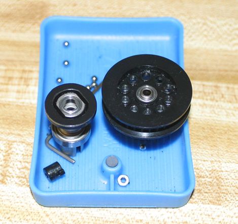

Take your diff apart, deived the diff into 2 parts and take all balls and grease out, like so
post-14948-0-42094400-1300191475_thumb.j

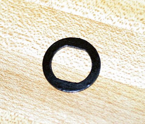

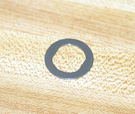

Place a diff plate onto some elctrical tape.... I tried some Fiber glass tape and it works so much better, cut and trim like pic 3/4 ,
post-14948-0-79523500-1300191480_thumb.j
One bare side,
post-14948-0-24961100-1300191486_thumb.j
One taped side,
post-14948-0-56410100-1300191495_thumb.j
I put tape on one side of each plate ( locks so much nicer and stronger, with the fiber glass tape )

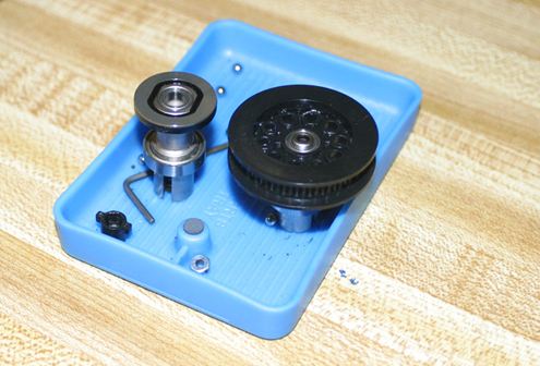

Glue the diff plates to the diff housings with tape facing out wards like so,
post-14948-0-64914900-1300191502_thumb.j
Put back together and all done ready for drifting... You can also do this to your front diff for TC racing good.gif
